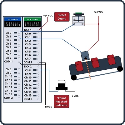

To illustrate the use of a counter instruction, we will analyze a PLC-based system designed to count objects as they pass down a conveyor belt:
In this system, a typical photoeye, or optoelectronic sensor beam causes the light sensor to close its output contact when an object is detected, energizing discrete channel In.1. When an object on the conveyor belt passes in front of the light beam from the source to the sensor, the sensor’s contact closes, passing power to input In.1. A pushbutton switch connected to activate discrete input In.0 when pressed will serve as a manual “reset” of the count value. An indicator lamp connected to one of the discrete output channels will serve as an indicator of when the object count value has exceeded some pre-set limit.
We will now analyze a simple Ladder Diagram program designed to increment a counter instruction each time the light beam breaks:
This particular counter instruction (CTU) is an incrementing counter, which means it counts “up” with each off-to-on transition input to its “EN” input. The normally-closed virtual contact (Sensor In.1) is typically held in the “open” state when the light beam is continuous, by virtue of the fact the sensor energizes the discrete input channel when the beam is broken by a passing object on the conveyor belt. When this happen, the input channel energizes, causing the virtual contact Sensor In.1 to “close” and send virtual power to the “EN” input of the counter instruction. This increments the counter just as the leading edge of the object breaks the beam. The second input of the counter instruction box (“RES”) is the reset input, receiving virtual power from the contact Reset In.0 whenever the reset pushbutton is pressed. If this input is activated, the counter immediately resets its current value (CV) to zero.
Status indication is shown in this Ladder Diagram program, with the counter’s preset value (PV) of 25 and the counter’s current value (CV) of 0 shown highlighted in blue. The preset value is something programmed into the counter instruction before the system is put into service, and it serves as a threshold for activating the counter’s output (Q), which in this case would be used to turn on the count indicator lamp (the Out.8 coil). According to the IEC 61131-3 programming standard, this counter output should activate whenever the current value is equal to or greater than the preset value (Q is active if CV \(\geq\) PV).
This is the status of the same program after more than 25 objects have passed by the sensor on the conveyor belt. As you can see, the current value of the counter has increased to 27, exceeding the preset value and activating the discrete output:
