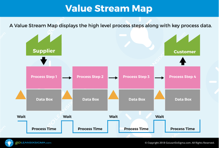

Step 2: Identify the Path That Value Takes to the Customer
Having identified the value you deliver, you must analyze your operation to understand what departments, processes, tasks, and actions directly or indirectly add value to the product.
Lean practitioners call this step mapping the value stream, which you begin by charting the end-to-end process your business currently follows to deliver a finished product to your customer, starting with raw material input from suppliers and finishing with delivery to the customer premises.
Capture each step, including administrative processes, approvals, tests, and inspections. Don't forget support functions. If you're paying someone to do something, capture their input.
Figure 2. Value stream map. Image used courtesy of GoLeanSixSigma
Having graphically captured your current state, you can remodel the value stream into your future state. Look at each step in the process and question its value. Direct tasks may be a step in the assembly process, and indirect ones might be a scheduling or quality team.
The indirect tasks can take some thinking. Although the customer cannot see your scheduling or quality teams or wish to pay for them, on-time and defect-free product delivery enhances customer value. Consider any tasks, departments, or processes that do not add or enhance value to the customer as waste for removal.

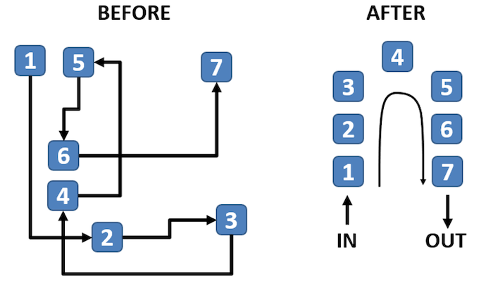

Step 3: Smooth Value Delivery and Remove Bottlenecks
When lean practitioners speak of flow, they refer to the smooth, efficient, optimized flow of value through an organization. This step identifies any bottlenecks, flow reversals, queuing, or delays and then works actively to resolve them.
Figure 3. Before and after aligning the path of value delivery. Image used courtesy of Lean Six Sigma Definition
Approval processes, work-in-progress queues, and machine setup times are common bottlenecks. If you can't remove them entirely, aim to simplify or minimize their impact. Don't forget to consider routing through your facility by tracking a product through all stages of production.
If the path is tortuous, involves frequent idle time, or requires multiple handling, consider rerouting the flow to suit product tasks rather than functional departments. Reducing travel distances and repeated handling adds immeasurably to efficiency while reducing possible ergonomic and safety issues.

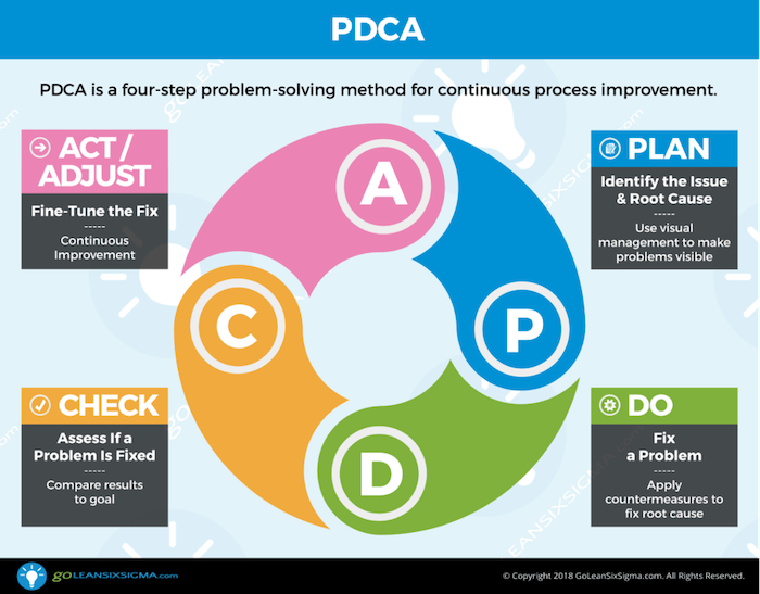

Step 5: Pursue Continual Improvement
Lean production is not a "fire and forget" philosophy: it requires instilling a cultural shift into your teams to actively and repeatedly seek to identify waste, enhance processes, and add value. Neither is lean a top-down strategic initiative; instead, it requires empowering workers and giving them the responsibility to own their tasks and perform independently.
Figure 4. The method of continuous process improvement. Image used courtesy of GoLeanSixSigma
The Deming cycle, known to many as the Plan-Do-Check-Act (PDCA) model, emphasizes continuous improvement in process management. Lean practitioners utilize the PDCA model to seek waste for removal in a never-ending cycle. As the last step in the cycle, the Act category ensures all stakeholders understand the outcome of the last implemented change while recommending the next issue for resolution, creating continuous improvement.
