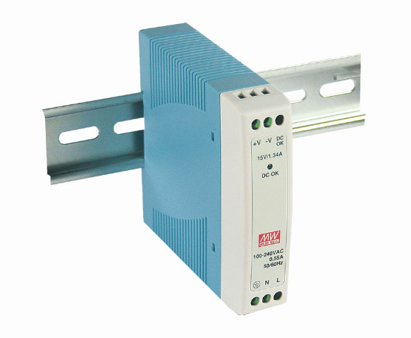

AC-DC DIN Rail Power Supply. Image used courtesy of MEAN WELL
With the growth of industrial automation comes a need for DIN Rail power solutions, including AC-DC power supplies, DC-DC converters, uninterruptible power supplies (UPS), and the necessary accessories.

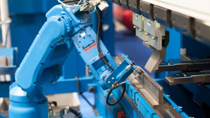

Robotic arms are one of the most common and well-known industrial automation applications. These robots serve many purposes, including machine loading, material removal, palletizing, part selection, and packaging, and they serve as a good example of the need for effective power solutions. These robots typically depend on DIN Rail power supplies and converters.
An industrial robot arm, for example, requires both an AC-DC power supply for normal operation as well as a DC-DC stage to charge the battery during normal operation via the UPS module. During AC power loss, the traditional solution for providing backup power is a system composed of the battery, UPS, and DC-DC converter.
A robotic arm that can "park" the moving parts into position.
A reliable backup power source is vital for industrial robot arms to “park” the moving parts in a safe position and save information about the production stage and progress. However, a DBUF buffer module can be used in place of the Battery, UPS, and DC-DC system—as long as only a small amount of backup power is required for saving the production stage and progress.
