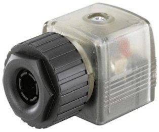

DIN Connector
Figure 1. DIN Connector. Image used courtesy of Tameson
DIN connector enclosures protect the electrical circuitry from outside influences and are often rated to IP 65 or IP 67. According to DIN EN 175301-803, the DIN connectors can be used with either hydraulic or pneumatic solenoid valves.

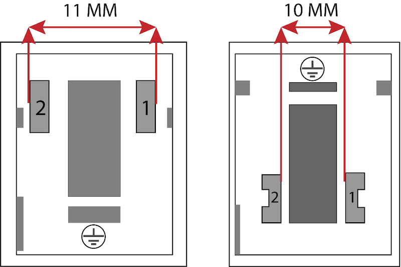

DIN EN 175301-803 Form B Connectors
Form B DIN connectors for solenoid valves are also called micro connectors. Two main differences set them apart from the Form A connectors.
Firstly, they have a smaller space between the pins, and the connectors can also have two different pin spacings: 10 mm and 11 mm. The 11 mm DIN connectors have three flat blade contacts and are the most common. The 10mm DIN connectors have one flat blade and two U-shaped pins pointing outward, as seen in figure 3.
DIN EN 175301-803 Connectors Form B
Figure 3. DIN EN 175301-803 Connectors Form B. The 11 mm connector with three flat blades is on the left, and the 10 mm connector with one flat blade and two U-shaped pins is on the right. Image used courtesy of Tameson

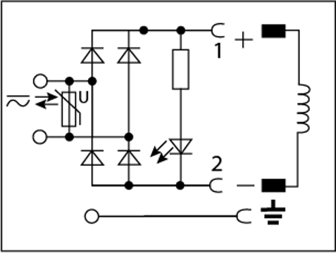

 Circuit with a rectifier, LED, and varistor
Figure 5. Circuit with a rectifier, LED, and varistor. Image used courtesy of Tameson
Rectifier
The rectifier circuit converts AC power into DC power. As the circuit typically uses a full-wave rectifier, 90% of the AC voltage is converted to DC. In other words, if you input 230 V AC, it will output ~207 V DC.
Compared to AC solenoids, DC solenoids are quieter, have no inrush current, and can be powered by batteries. Conversely, AC solenoids can be powered by line power, have faster response times, and run cooler.
Pole Protection and Freewheeling Diode
Protecting a switching DC power supply from transient voltage spikes is accomplished through a freewheeling diode and pole protection circuit. A magnetic field is generated when a solenoid coil is powered. If the power supply is shut off, a short-term back electromotive force (EMF) voltage can cause arcing across the switch.
This can be prevented by placing a freewheeling diode across the load, also known as a flyback diode. Current is redirected through the diode instead of the switch when the switch is open. The current is dissipated through the coil rather than across the switch. To redirect the current back through the coil and protect the switch, the polarity of the freewheeling diode in relation to the supply is a crucial aspect.
The diode controls current flow in a pole protector to ensure that the supply’s polarity is always correct. Detecting the wrong polarity will prevent the coil from conducting current. Because of the diode’s conductance properties, it is only feasible to use this circuit with DC power and DC-rated coils.
