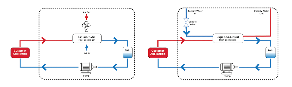

Liquid heat exchanger systems cool the coolant in a liquid circuit either by the use of a liquid-to-liquid heat exchanger or a liquid-to-air heat exchanger. In the first case, the coolant is often cooled below ambient temperature using a facility (often called primary) coolant loop. Alternatively, the air-cooled system will cool the coolant to near ambient temperature. The remainder of the systems consist of a pump to circulate the coolant, often a tank to ensure the pump is constantly being supplied with liquid, and a liquid circuit to transfer coolant from the heat source to the liquid cooling system.
Figure 1. Liquid-to-air vs. liquid-to-liquid cooling

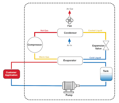

Liquid chillers (recirculating chillers) encompass a compressor system instead of a liquid heat exchanger assembly. It is used to cool the coolant to well below ambient temperatures and dissipate heat to the outside environment.
Figure 2. Liquid chiller system
