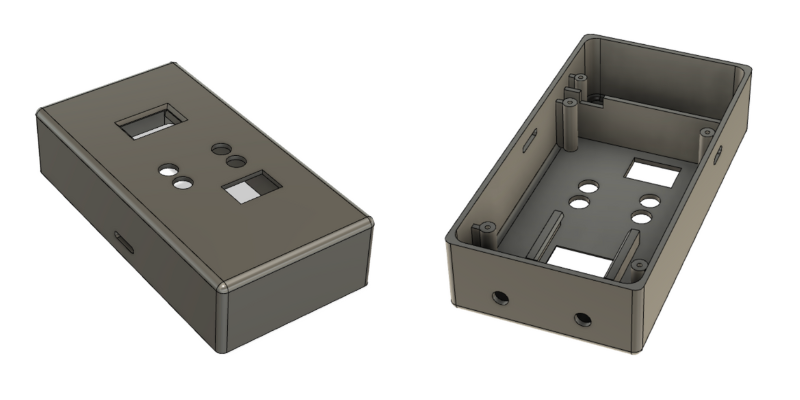

A custom medical device enclosure was designed in Autodesk Fusion 360, shown in Figure 2. The device has a small LCD screen, four round pushbuttons, one square connector, two front jacks, and a single USB connector on the side. A utilitarian industrial design was used with simple shapes and filets. A variety of ribs, bosses, and supports are included internally for mounting the PCB and other wired components.
Mechanical limitation for PCB enclosure
Figure 2. Medical device enclosure design.

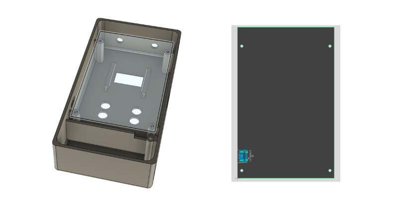

To begin the electrical design process, the mechanical engineer must provide a PCB board shape to the electrical engineer. This can be accomplished in Fusion 360 in several ways, but one of the most common is to create an offset plane relative to the mounting bosses and then sketch the board shape on that plane. From this single sketch, Fusion 360 offers a command that will convert directly to a PCB for further design in the Fusion 360 electronics persona. Figure 3 demonstrates this process and the resulting 2D PCB ready for handoff.
PCB shape and size
Figure 3. 3D sketch conversion to 2D PCB.

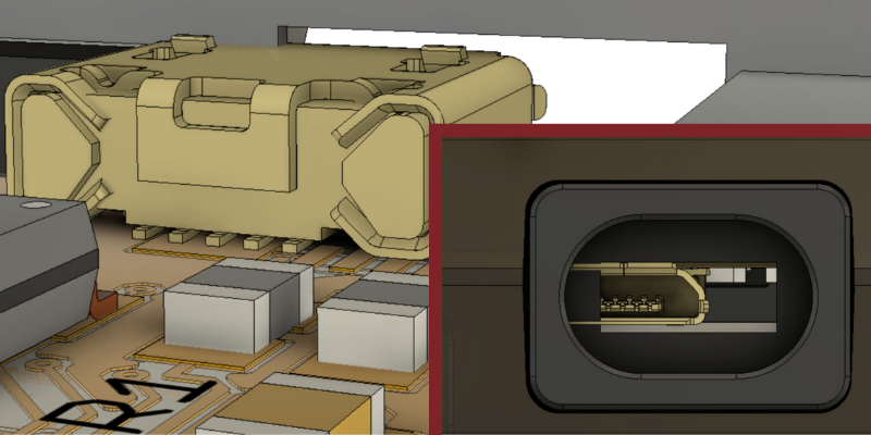

Once the components are selected and positioned on both sides of the PCB, this data is pushed to the 3D PCB for further analysis by the mechanical team. As shown in Figure 4, the selected USB placement is misaligned with the enclosure opening and will require modification.
USB port misalignment
Figure 4. USB connector misaligned with enclosure opening.

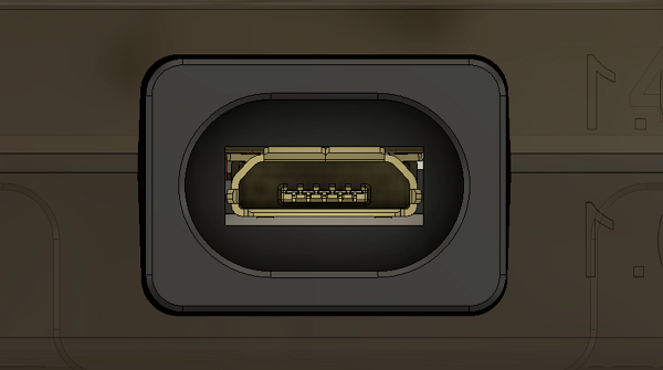

To correct any such placement issues, the mechanical team can provide refinement direction to the electrical designers. In the USB example above, the component must be moved to the other side of the board and shifted in the Y direction by 100 mils.
It is important that all of these placement issues be fixed before any electrical routing is performed. Otherwise, significant time and effort can be wasted ripping up traces and rerouting for relatively simple component shifts. As seen in Figure 5, once the PCB placements are updated, the USB connector lines up perfectly with the enclosure opening.
Properly aligned USB port
Figure 5. USB connector properly aligned with enclosure opening.
