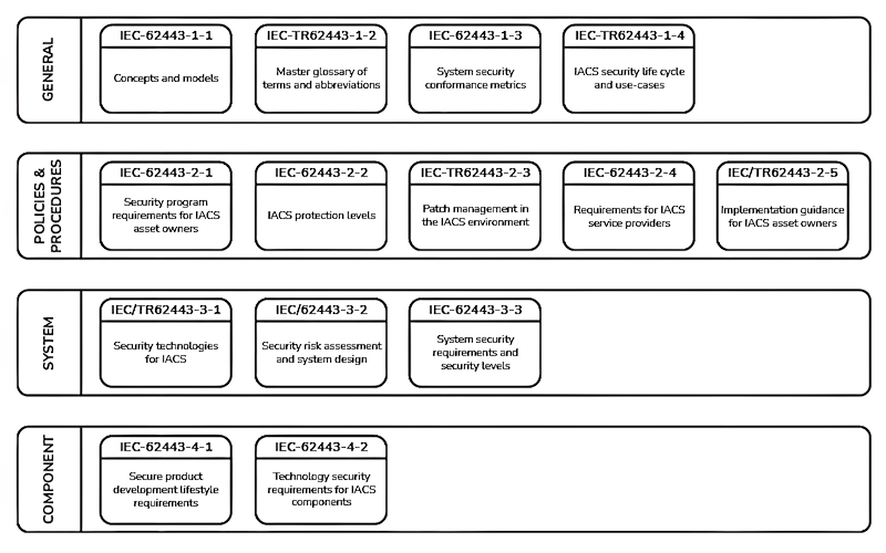

How IEC 62443 Helps Alleviate the Increasing Threat of Cyberattacks
IEC 62443 is a set of standards developed by industry-leading security experts to provide a holistic protection scheme for operational technology in industrial automation and control systems (IACS). It describes technical and process-related aspects and comprises four blocks that address all parts of an industrial design, from the supplier level to the individual devices and components to the complete IACS.
Figure 2. Four distinct sections define the IEC 62443 standard, from general terms to component level requirements.
The first block within the IEC 62443 standard defines the terminology, concepts, and methods used throughout the standard.
The second unit describes different roles, such as industrial facilities. For example, part 2-1 (IEC 62443-2-1) describes requirements for how operators of automation solutions have to consider security during a plant’s operation.
While part three focuses on cybersecurity measures for systems, the fourth part of the standard, aimed at embedded product suppliers, describes the technical requirements for the components in a product’s lifecycle. Besides defining technical requirements for components, this section further discusses four common component security constraints (CCSC) that a component must meet in order to comply with IEC 62443-4-2. In particular, CCSC 4, one of these constraints, states that the product must be developed with an IEC 62443-4-1 compliant process.
Further, IEC 62443 describes five security levels an IACS system can achieve. The standard defines these security levels and guides protection against security violations. For example, the lowest security level, SL0, describes a system that requires no special protection. In contrast, the highest possible level (SL4) classifies a system that requires protection against intentional security violation by an advisory with sophisticated means and extended resources: for example, a group of professional hackers trying to blackmail a company into paying a multi-million dollar ransom. Each security level defines a set of requirements that a system or component must fulfill to comply with that security level. So, for example, to comply with IEC 62443-4-2 on security level three (SL3), an IIoT solution must fulfill each criterion from the following list:

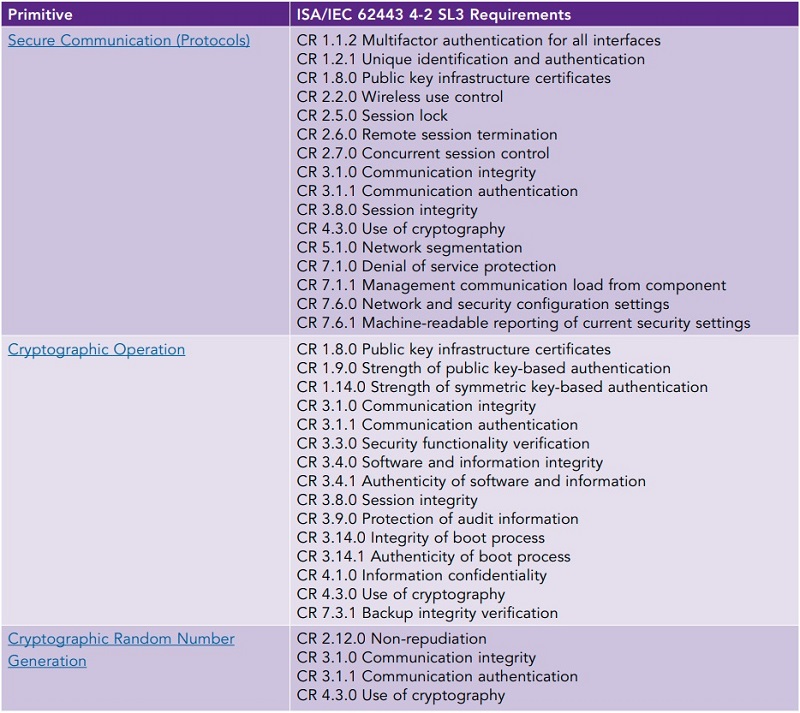

ISA/IEC 62443 4-2 SL3 requirements
Figure 3. Resulting requirements for ISA/IEC 62443 4-2 SL3. Image used courtesy of NXP, “Security Primitives Nomenclature”

NXP defined a set of security primitives to establish common grounds for security nomenclature in the IIoT sphere. The document describes security features on multiple levels distilled from various standards. It explains a framework that allows engineers to think about the security requirements of their products in a structured way. System designers can use this method to map certification and standard criteria and use-case requirements to product capabilities and vice versa. The framework aids engineers in selecting and integrating solutions that fulfill all their needs, for example, achieving IEC 62443-4-2 compliance in an automated way.
