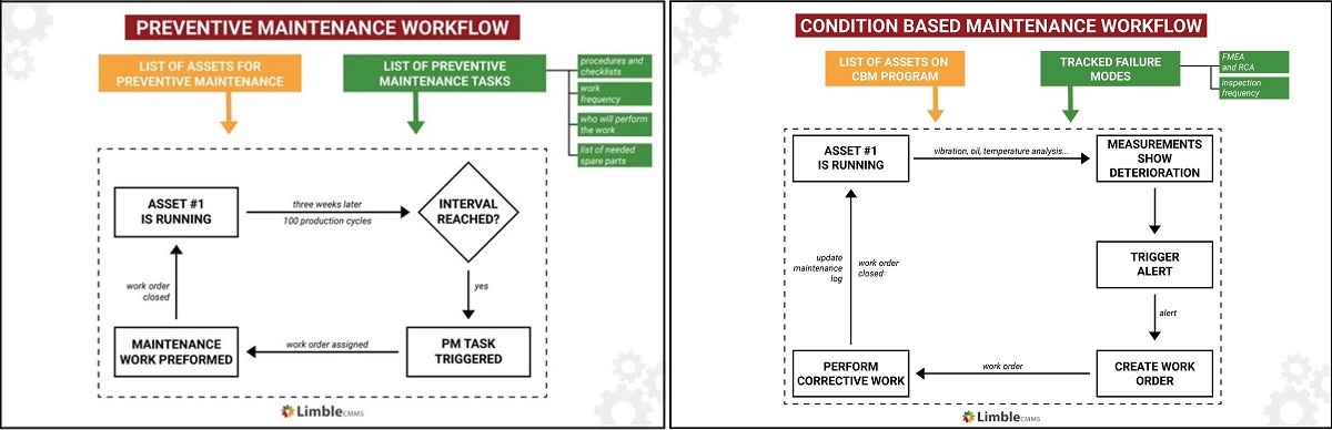

Predictive Maintenance analytical software will create challenges if not integrated with local machinery I/O and controllers
Figure 3. Software is the heart of a predictive maintenance system, which is why having it integrated with the local machinery I/O and controllers is crucial (click to enlarge). Image used courtesy of LimbleCMMS
3. Software Isn’t Integrated With the Machinery
If predictive maintenance analytical software isn’t integrated with the local machinery I/O and controllers, there will be no ability to respond to commands, and it will create difficulties in running successful predictive software analytics.
This will result in the loss of critical data from the controller (fed through different condition monitoring devices) and failure to make timely and accurate decisions.
Software is the heart of a predictive maintenance system, which performs vital information collection functions, keeping historical trends, and predicting and planning maintenance activities. It stores all the necessary information and compares it with the standard variables to predict and diagnose the fault.
