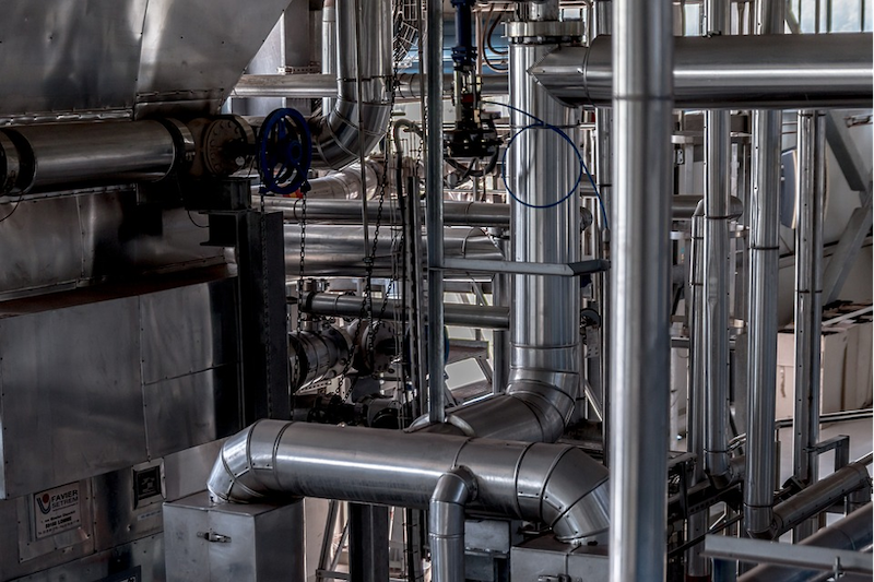

industrial energy system
Figure 1. An industrial HVAC system. Image used courtesy of Pixabay
1. Optimize Routine Maintenance Schedules
The first step toward managing maintenance work for industrial energy systems is paying close attention to recommendations provided by the equipment manufacturer. Equipment failure occurs due to aging parts, using defective spare parts, or deferring maintenance work. Adhering to routine maintenance schedules enables maintenance technicians to identify early signs of failures. Companies can extend the useful lives of energy systems by appropriately scheduling routine inspections and performing complete preventive maintenance work.

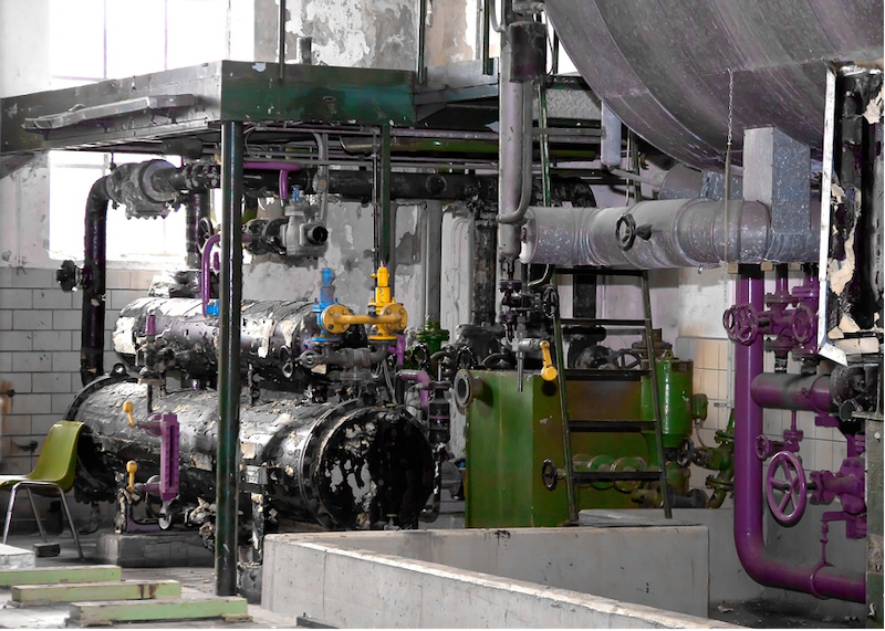

Figure 2. An industrial heater. Image used courtesy of Pixabay
Furnaces
Industrial furnaces heat air using oil, gas, or electricity. They distribute the warm air through ducts and supply it to internal spaces through registers. Some preventive maintenance actions include:
  • Filters — Clean filters frequently. It could be monthly or quarterly, depending on how clean the working environment is. Replace old or broken filters.
  • Combustion systems — Use visual inspection or non-destructive testing tools to check the combustion chamber for cracks. Check for leaks in connections between the furnace and ducts. Regularly clean the burner.
  • Blowers and fans — Regularly lubricate the blower motor. Check the bearings for any signs of wear.
  • Duct systems — Inspect the ducts for leakages and seal all leaking points.
  • Valves — Install the correct type of regulators and regularly inspect valves for leakages.
  • Electric cabling — Ensure all electrical cables are properly insulated. Confirm if the spark plugs are well-grounded. Calibrate spark plugs to maintain the appropriate ignition gap.

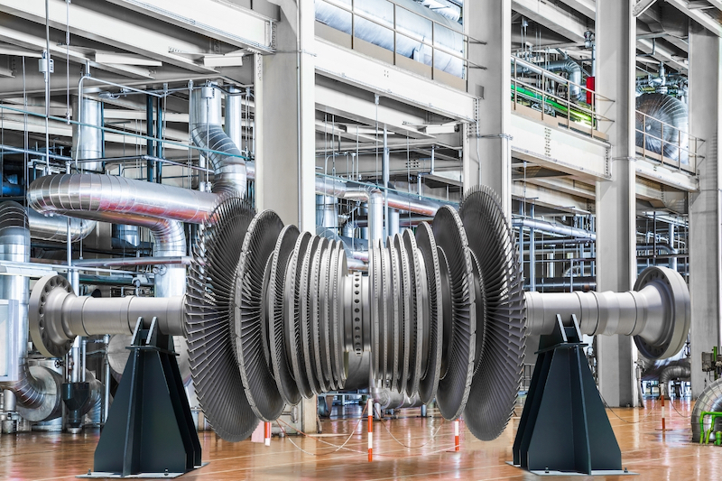

Turbines
The reliability and performance of turbines depend on the quality of steam. Steam turbines consist of several interdependent components that require frequent preventive maintenance.
  • Turbine blades — Inspect turbine blades for signs of wear, cracks, or deformations. Confirm the structural reliability of blade connectors. It is advisable to conduct turbine blade inspections annually.
  • Rotors — Conduct regular inspection of rotor bearings. Check the alignment of rotors.
  • Lubrication systems — Frequently verify the amount of lubricant in the system. Check the lubrication system for signs of leakages. Clean the lubrication filters and drain dirty oil.
  • Control valves — Inspect control valves for corrosion. Replace old valves with automatic steam control valves.
  • Steam lines and piping systems — Inspect all steam lines and connection joints for leakages. Perform non-destructive testing to identify points of structural weakness due to corrosion or sediment accumulation.
industrial steam turbine
Figure 3. An industrial steam turbine.
