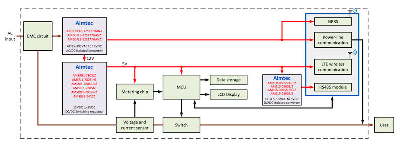

Smart Meters
A smart meter is a digitized version of the traditional meter. It includes a voltage sensor and a current sensor for basic metering functions. It also includes communication modules, which allows it to report the power usage information to the energy management system.
Depending on where and how the meter is installed, the communication module can be general packet radio service or long-term evolution (GPRS/LTE) for devices installed in remote locations and power line communication/RS485 for devices installed in the same or adjacent buildings. In addition, the meter can also be equipped with a power switch for remote power control.
A smart meter system
Figure 1. A smart meter system. Image used courtesy of Aimtec
As the meter is usually placed at the system input, it is prone to interference by external factors. An electromagnetic capability (EMC) protection device or circuit at the input of the power converter is mandatory. The alternating current (AC) input from the grid is converted into 12 V by an isolated AC/DC converter to supply the GPRS and power line communication module.
Products such as Aimtec’s open frame series can accept an input voltage range of 85–305 VAC, which supports a single-line three-phase input and offers isolation protection to the downstream devices. The 12 V is then stepped down to 5 V to power the metering unit, microcontroller unit (MCU), LTE module, and RS485 module. As the RS485 is an isolated communication module, an additional 5 V to 5 V isolated converter is required.

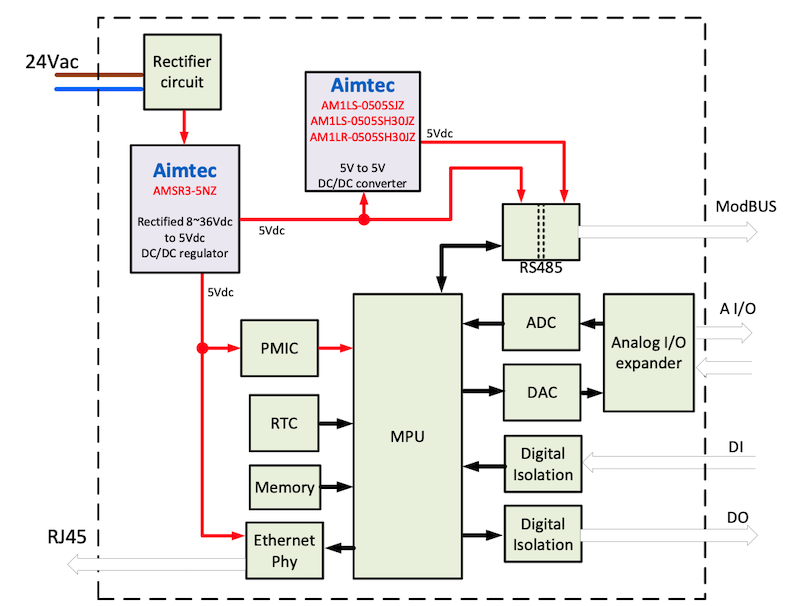

BACnet Building Controllers
BACnet is a standardized building automation communication protocol that is widely used in HVAC systems. The protocol can also control lighting, security, and fire alarm systems. A BACnet controller is designed to be widely utilized in all kinds of building automation subsystems. The RS485 and RJ45 ports also ensure interconnectivity.
A BACnet building controller
Figure 2. A BACnet building controller. Image used courtesy of Aimtec
The system in the below example uses the common 24 VAC as the input power source. The 24 VAC input is rectified into DC and then converted into 5 VDC by a DC/DC switching regulator. As the main processing unit is more complex, the power supply of the micro-processing unit (MPU) and surrounding components are handled by power management integrated circuits (PMICs). The RS485 and ethernet modules are powered directly by 5 V and with no exception, an isolated 5 V to 5 V DC converter is placed for the RS485 communication.

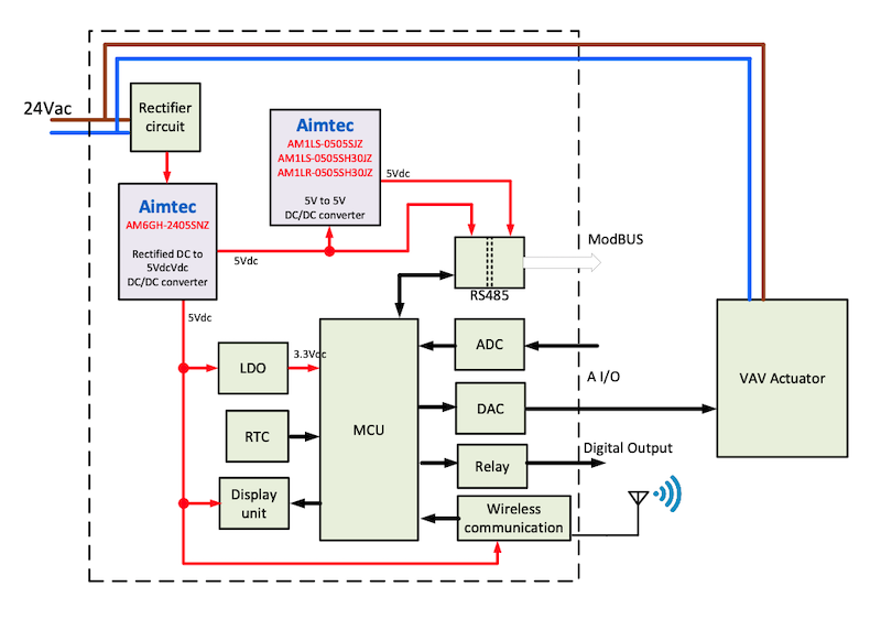

Variable Air Volume (VAV) Controllers
Unlike traditional constant air volume controllers that control a compressor’s times of operation, a variable air volume (VAV) controller achieves the temperature setpoint by adjusting the air volume instead of toggling the compressor’s on/off states.
The VAV controller can effectively reduce the compressor’s wear and achieve more precise temperature control. With the wireless connectivity and RS485, the VAV controller can report the temperature information and possible unit fault conditions to the system. Furthermore, the AC can be shut off and adjusted remotely for energy savings.
Similar to the BACnet controller, the 24 VAC input is rectified and serves as the input to the DC/DC converter. The communication modules and display are powered by 5 V from the DC/DC converter while a low-dropout regulator (LDO) supplies 3.3 V to the MCU.
Variable air volume controller
Figure 3. Variable air volume controller. Image used courtesy of Aimtec

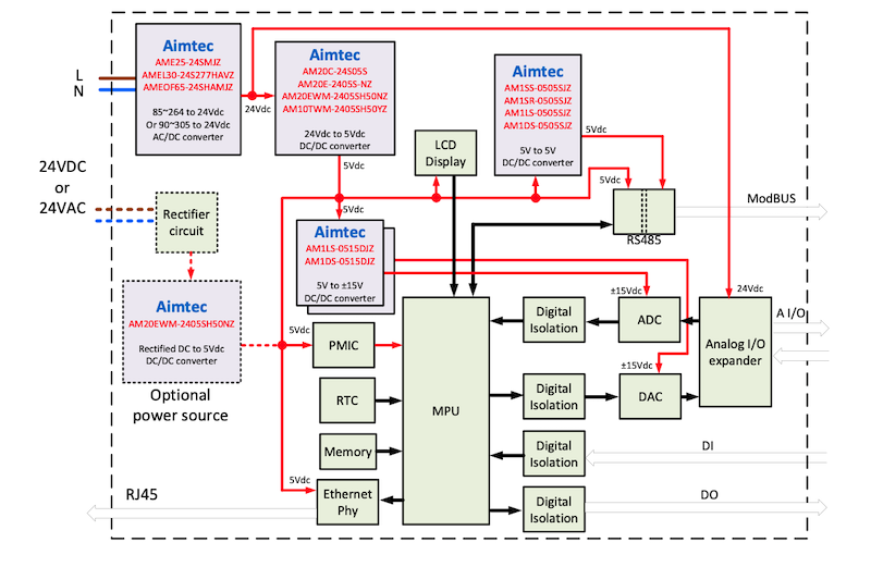

Programmable Automation Controllers
Building automation is a complex undertaking; multiple systems need to work together to achieve the desired result. Besides the aforementioned systems, many other devices need to have a certain level of automation control.
This is where the general-purpose programmable automation controller can step in. The controller is equipped with a digital and analog I/O to allow for multiple types of sensor inputs and control signal outputs. The RJ45 and RS485 connectivity allow the system to work with other devices and exchange information.
The controller in the example has the option of using the 110 VAC, 220/240 VAC, or 24 VAC as the power source. For 24 VAC, the power is rectified to DC and converted into 5 VDC by an isolated DC/DC converter. The 5 V rail powers the display, connection modules, and PMIC. As the system equips analog-to-digital converter (ADC) and digital-to-analog converter (DAC), which requires ±15 VDC, a 1 W 5 V to ±15 VDC converter is used. For 110/220 VAC input, the power is first converted into 24 VDC then converted into 5 VDC. With 24 VDC power, the device can run an additional analog I/O expander.
Programmable automation controller
Figure 4. Programmable automation controller. Image used courtesy of Aimtec

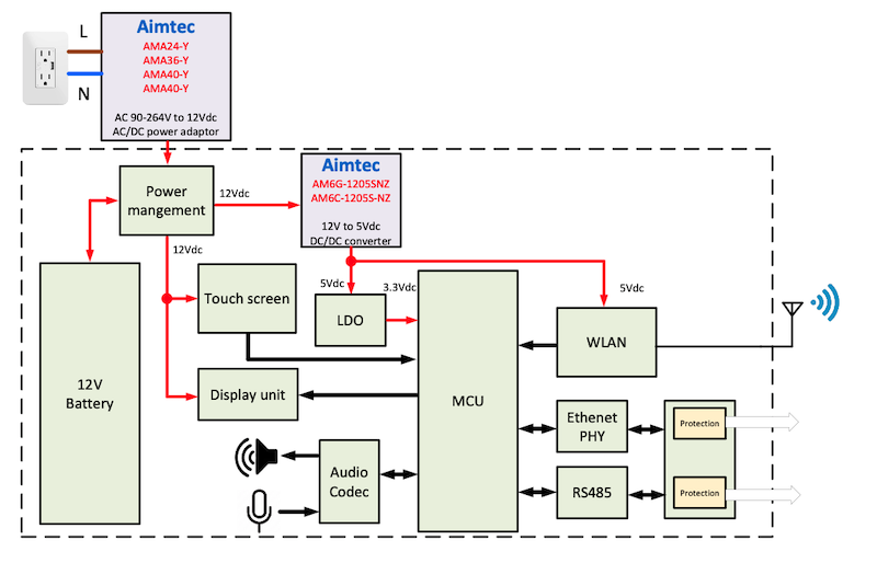

Automated HMIs
A complex automation system would require a visualized user interface (UI) to aid control and maintenance. The HMI (human-machine interface) consists of a high brightness display for better clarity under sunlight and a touchscreen for intuitive control. Serving as an automation control interface, wireless connectivity is a must. This provides the users with more flexibility in terms of controlling and monitoring the entire automation system status.
The HMI can also be used as a debugging tool. The ethernet and RS485 ports enable a direct connection to the control module, which allows onsite diagnostics when the problem cannot be solved remotely.
The HMI features a built-in 12 V battery for portability. For stationary monitoring and controlling, the device can be powered by a 12 V adapter. The 12 VDC powers the touchscreen and display unit directly as these two units usually consume more power. A 12 V to 5 V DC/DC converter powers the wireless communication module and the LDO for the MCU.
Automation HMI
Figure 5. Automation HMI. Image used courtesy of Aimtec
