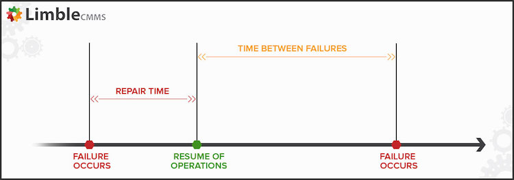

MTBF measures availability and reliability
Figure 2. MTBF measures availability and reliability. The higher the figure of the MTBF, the longer the system will likely run before failing. Image used courtesy of Limble
On the other hand, MTBF, shown in Figure 2, is a reliability measure that provides the average time between two failures occurring in a given period under the stated conditions, as shown in the equation below.
$$MTBF =\frac{Total~Operational~Time}{Total~Number~of~Failures}$$
