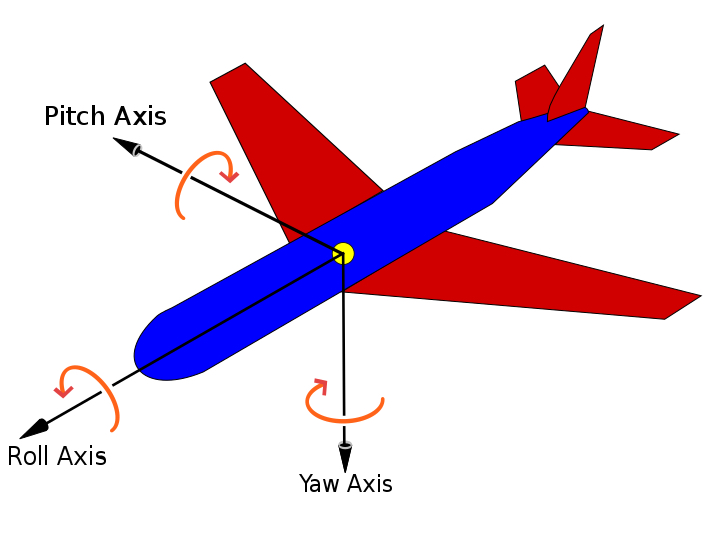

Roll, pitch, and yaw motions. Image courtesy of Auawise
Onboard telemetry measurements showed roll and pitch measurements (left to right and front to back) that exceeded 20° and large spikes in power consumption during these oscillations. Also, several of the control inputs were showing larger-than-expected values.

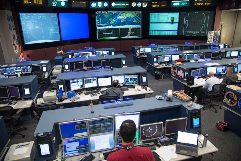

The Johnson Space Center's Mission Control Center. Image used courtesy of NASA
