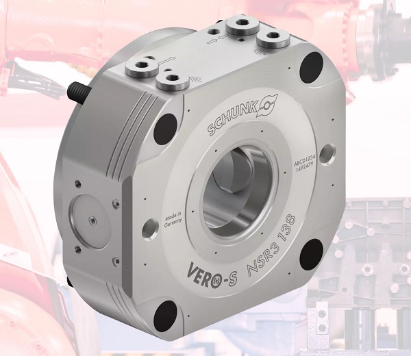

The new NSR3 138 coupling. Image used courtesy of SCHUNK
VERO-S NSR3 138 Coupling
Similar to the other VERO-S couplings, the NSR3 138 has been designed and built to handle heavy pallets for the robotic material handling industry. The NSR3 138 has the capability of handling pull-down forces of up to 8 kN, and a maximum moment of Mx = 1,500 Nm (approximately 1000 Nm more than the NSR 160) and My = 1,600 Nm. This coupling is spring-loaded, opening with 6 bar of compressed air. The NSR3 138 measures 129 mm x 112 mm x 55.7 mm, weighs only 3.8 kg, and is advertised as maintenance-free.
Most robotic applications require a highly accurate, repeatable positioning, but if the coupling that holds the tool isn’t accurate, your robot positions will not be accurate either. SCHUNK tools are well known for their reliability and accuracy, which is why the NSR3 138 has a repeat accuracy of <0.02 mm.
An integrated blow-off feature ensures that mating faces are clean and free of debris. The smallest amount of dirt could result in inaccurate positions or even tool failure.

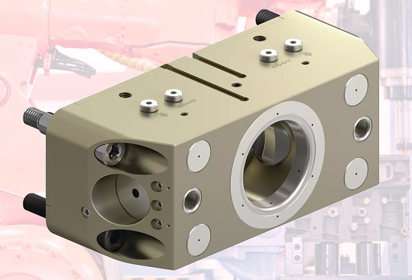

The previous coupling series from SCHUNK, the NSR 160. Image used courtesy of SCHUNK

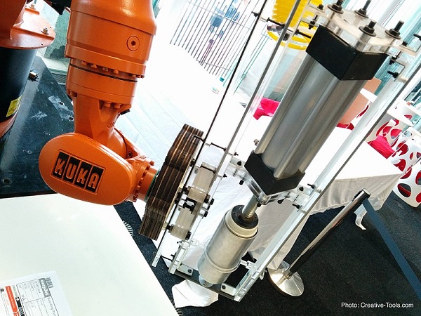

One example of a robot with an end tool, attached via a coupling. Image used courtesy of Wikipedia
