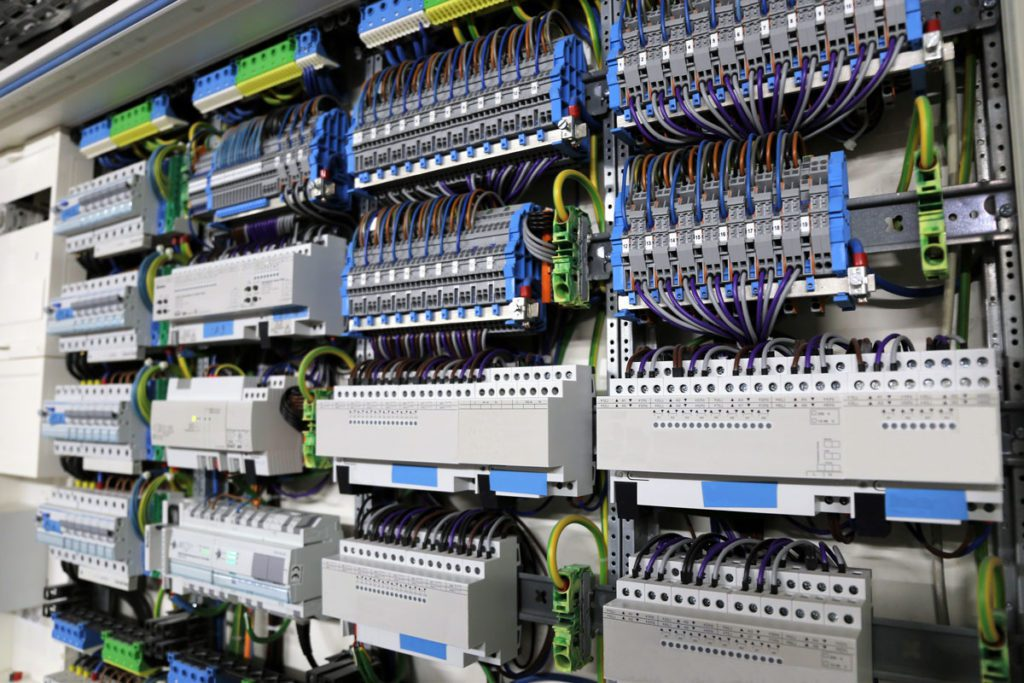

Electrical devices wired using schematics from the Panel Builder software. Image used courtesy of Zuken

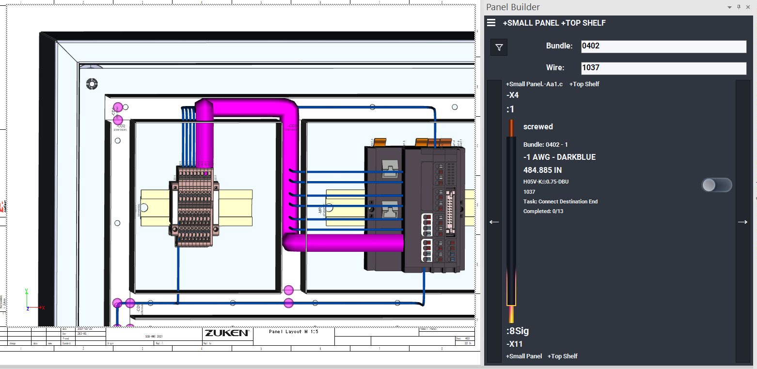

A demonstration of using the wiring task manager within Panel builder. Image used courtesy of Zuken
Wiring Task Manager
In a traditional build space, the engineering department uses electrical schematics to show how devices are connected within an electrical circuit. It is then up to the technicians to read the schematics and determine how wires should run between these devices, and sometimes, even the panel layout is left up to the technicians.
With Panel Builder and the wiring task manager feature, the designer can design wire paths and even output wiring instructions. The wiring task manager provides clear visual instructions to operators on the shop floor and can be used with single or multi-panel installations.
These digital instructions can also be connected to a central database, which remains in sync with the assembly process, providing real-time feedback on the process, which can be analyzed later to determine inefficiencies within the assembly.

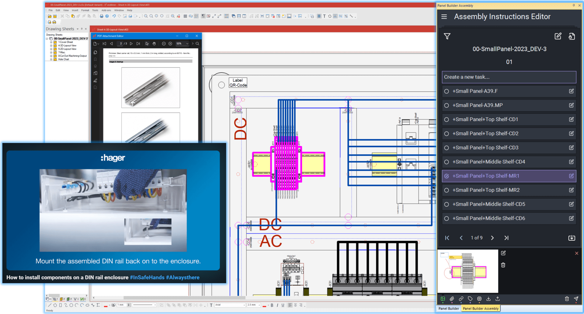

Assembly task manager within Panel Builder provides clear visual instructions to operators and technicians. Image used courtesy of Zuken
The placement of devices within a control cabinet is critical. If the panel layout doesn’t flow properly, the wiring will be messy and could cause electrical noise. The assembly task manager allows designers to play with different locations in a digital space and produce detailed work instructions similar to the wiring task manager.
These instructions can be connected to a centralized database for real-time monitoring of the assembly process. The digital instructions can also be sent directly to tablets for operators to step through and confirm the build process.
