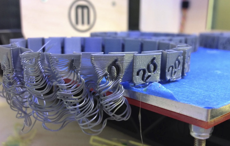

An example of a 3D printing failure. Image courtesy of All3DP.

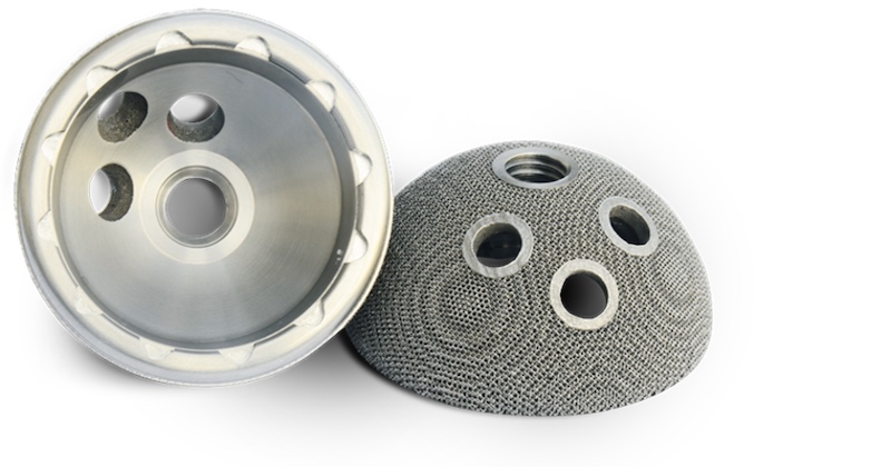

Direct metal printing. Image courtesy of 3D Systems, Inc
Additionally, part properties between powders, processes, and machines have shown a range of performance in similar parts. Even the amount or volume of parts in a build have been noted to have varying properties.
This might be due to heat history or thermal processes that can experience changes from layer to layer. While part orientation is important to material properties, in powder bed fusion processes, thermal stresses can be introduced to the part during the process. Controlling the temperature in the build space is important. Techniques have been documented where using the build tray or walls as a heat sink can help mitigate thermal stresses in parts.

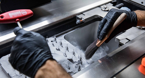

Post processes such as hot isostatic pressing (HIP) help to decrease voids, but the mechanical characteristics in high-cycle fatigue still need more testing.
Additionally, researchers and engineers need ways to monitor 3D printing in real-time during builds and more cost-effective non-destructive testing inspection methods.
Post-processing in 3D metal printing. Image courtesy of Protolabs
