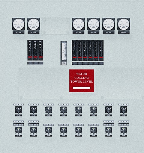

Simulated control panel
Figure 1. A hard panel for emulation. Image used courtesy of nHance Technologies

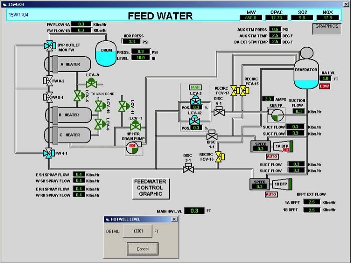

In the early days, we typically used toggle switches, indicators, and analog panel meters for simulation (Figure 1). Later, we advanced to using off-the-shelf simulation software like a standard Modbus server, OPC server, or hard-wired PLC for simulation. To interact with the simulation system, we built some kind of graphical interface for display and control (Figure 2) to test the control system that we have developed.

SCADA HMI simulation
Figure 2. Emulated HMI. Image used courtesy of nHance Technologies

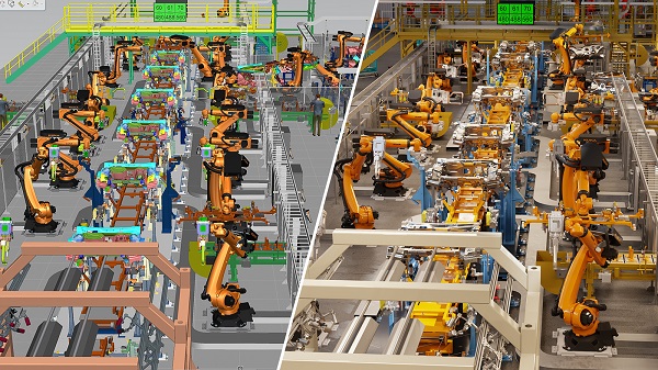

Digital twin factory
Figure 3. A digital replica of a conceptual factory. Image used courtesy of NVIDIA
