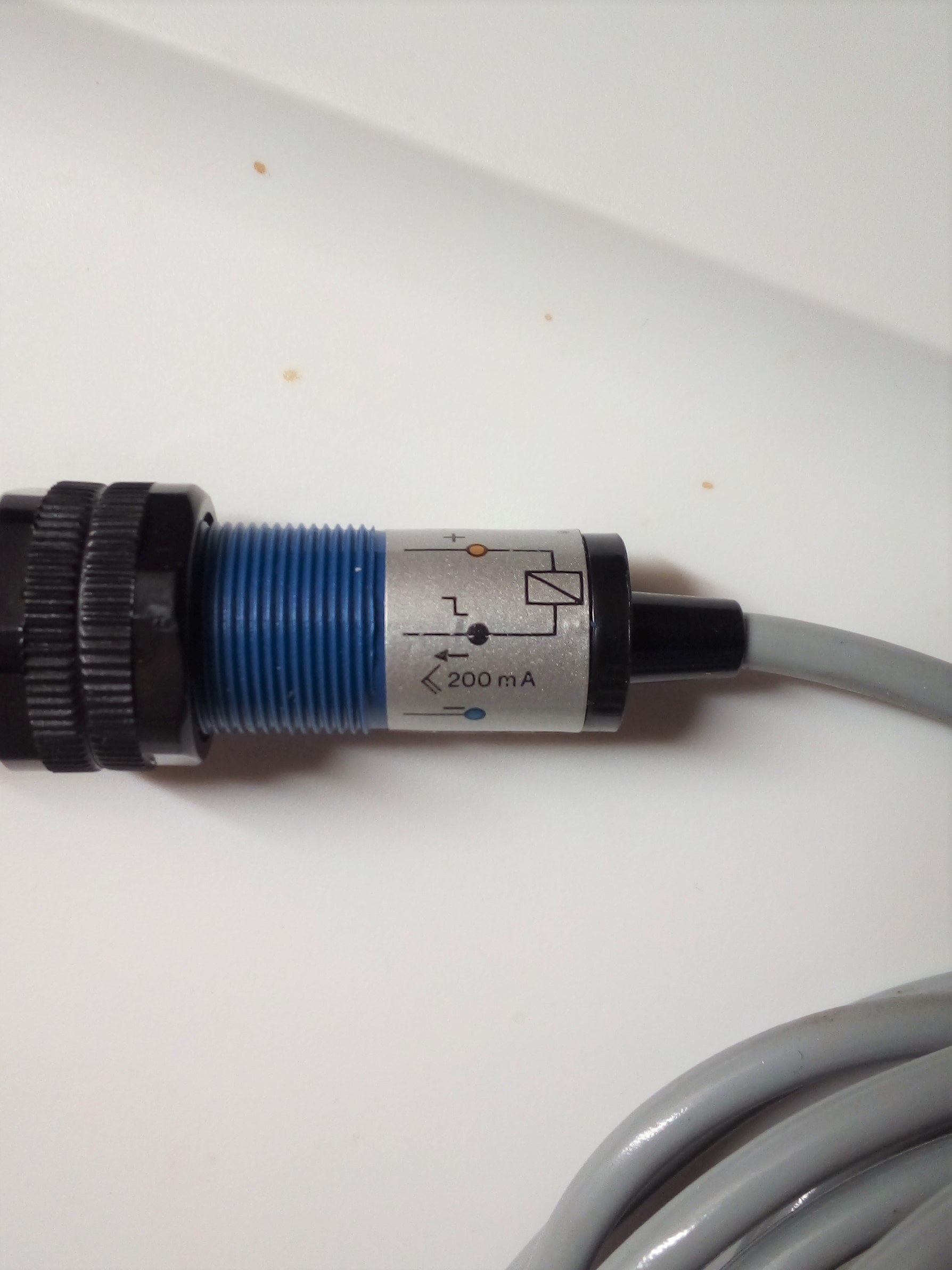

The back of a typical PNP optical sensor. This sensor shows the connection to the load device with both Normally Open and Normally Closed options.

If a datasheet is not readily available, but a diagram is printed on the side or end of the sensor, this diagram will have some way of identifying a ‘load’ device. Sometimes the word LOAD may be seen.
Sometimes, a small rectangle with lines on both sides will represent the load. Other times, an arrow on one wire may indicate which direction electricity flows to or from the load. But no matter the case, the PLC terminal is our ‘load’.
If an arrow points toward the load, this means current is sent OUT from the sensor, so it’s a PNP type. A load rectangle will have two lines connecting to it, one from the sensor, and the other connecting to either + or - voltage.
If the load rectangle connects to the - voltage, this means that the load returns to the ground or is a ‘sinking’ type load. So the current must be sent IN TO the load, and OUT from the sensor, and we have positively identified a PNP sensor.
