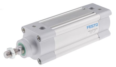

Benefits and Uses of Pneumatic Actuators
Pneumatic actuators are very similar to hydraulics in that fluid is used to provide actuation.
However, unlike a hydraulic actuator, a pneumatic actuator uses air instead of a liquid. A pneumatic actuator is also capable of heavy loads but because air is compressible pneumatic systems are energy inefficient.
Pneumatic cylinder actuator from FESTO
Festo's DSBC Series pneumatic actuator. Image used courtesy of Festo
When pressure is applied to a pneumatic line there is a delay in energy transfer which not only affects the maximum acceleration of a pneumatic system but response time as well. Pneumatics use air as their energy transfer medium which means that they are able to operate within a temperature range of (-40°C to +250°C), and are ideal for explosive atmospheres. But pneumatic actuators also suffer from implementation in that a pneumatic actuator is commonly designed for one job and cannot be used reliably in other applications.
