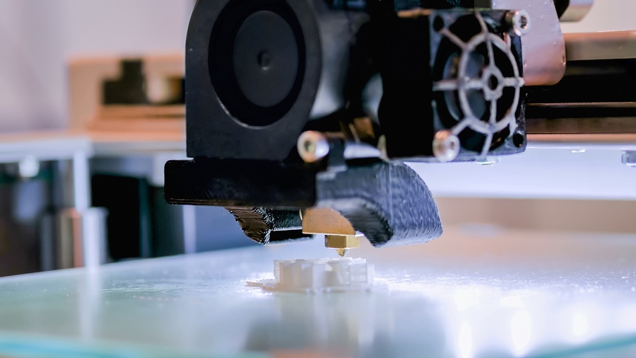

3d printing
Print head of 3D printer machine printing plastic model.
One benefit of these plastic parts, however, is their flexibility when compared to metal parts, which are often brittle. Some situations require a bit of flex from the part, and this can be achieved quite naturally on plastic parts without leading to cracking.

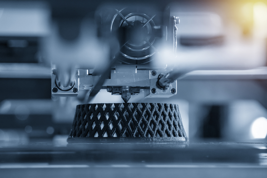

metal 3d printing
3D printing machine make of 3D prototype model by resin material.
There certainly are significant challenges shown from both processes - in plastics, the mechanical properties and strength are a weakness, and in metal, the cost of the machines and the parts are a prohibition for common industry integration.
