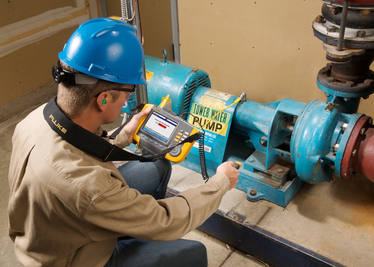

The vibration happens when cyclic motion from a motor transfers through some joint into the rest of the assembly. Not only does it waste energy, but it can damage the equipment. A proper bearing is employed to isolate a rotating element from the frame around it.
An engineer performing vibration analysis. Image courtesy of Fluke
Two issues can plague bearings, depending on whether it’s greased or dry. If the bearings are greased, then the failure might stem from contaminants of dust or water getting into the bearing with bad seals. If the grease runs too low or gets old, it can dry out and lead to further vibration.
On the other hand, if the bearing is without grease (often called a ‘bushing’), it relies instead on sliding motion rather than the balls or rollers of a bearing. Even most bushings do have an oily surface, but they rely simply on reducing friction - but friction regardless.
If these begin to fail, it’s due to the two surfaces wearing on each other. At that point, the material has been removed, and no amount of grease or oil will repair the surface. Only replacement will be sufficient as a solution.
With either type of bearing or bushing, refer to the manufacturer’s maintenance schedules to ensure that vibrations are minimized, and equipment longevity is maximized.

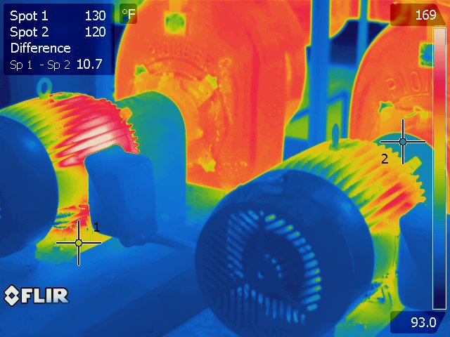

If you have experienced equipment with excessive vibration, you have most likely experienced this failure factor - heat. Nearly every motion, friction point, and electrical flow will increase heat. When heat energy is being wasted at any point in the system, that extra energy will further load the system.
A slow increase in power consumption can point to an increase in loss at some point in the system. If you want to find a failure, you can almost always trace it back to a heat loss to point at the suspect area.
Thermal problems can be a cascading issue, which makes them particularly dangerous. When metal heats up due to friction, it will expand, further increasing the friction. This, in turn again increases the heat, and the cycle continues until failure.
A thermal imaging camera showing conditions of a specific mechanical failure. Image courtesy of FLIR systems
In electrical systems, heat causes resistance, increasing the loss in voltage of the system, which causes an increase in current to move the load, again cascading the heat effects.
It is often useful to have an infrared thermometer or even a thermal imaging camera to help pinpoint areas of the system experiencing excessive heat.
