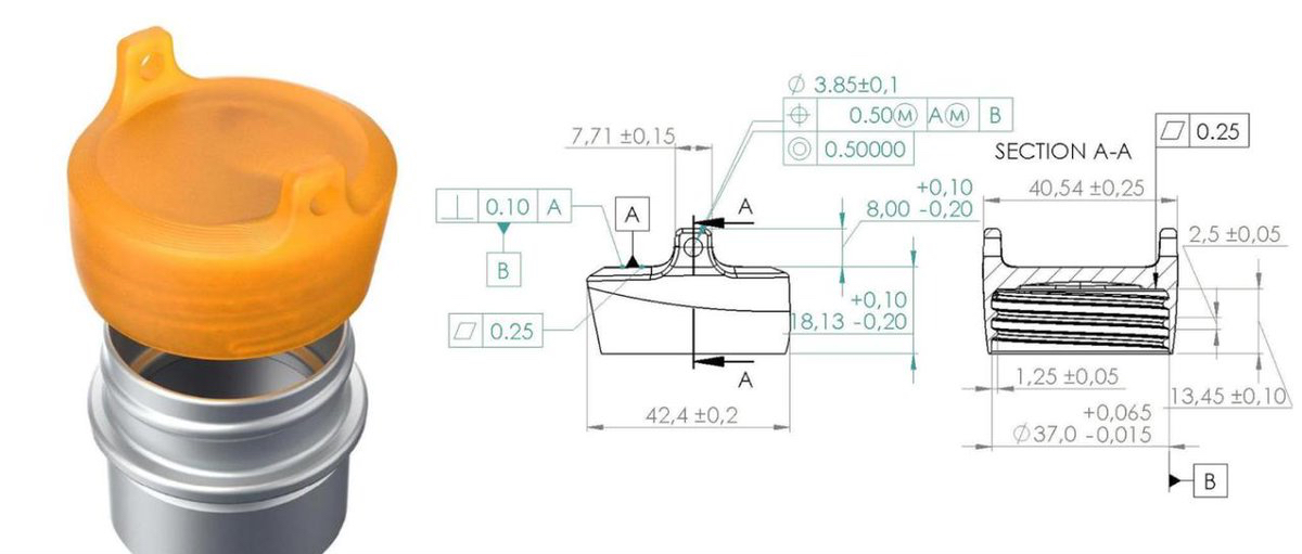

Geometric dimensioning and tolerancing (GD&T) has been a staple of design and manufacturing. Measuring devices such as calipers and micrometers can be found on machinists, CNC operators, and engineer’s desks around the world. While CAD software is making design easier, there are many processes that happen from the designer's computer to holding the finished part.
The Basics of Geometric Dimensioning and Tolerancing. Image used courtesy of Formlabs Inc

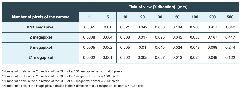

A pixel resolution reference value. Chart used courtesy of Keyence
The resolution is associated with how many pixels a camera has. With a 2 megapixel camera, there are 1,200 by 1,600 pixels. The field of view is, in short, the amount the camera can see, which will change with the distance between the camera and the object. From this and some math, the pixel resolution of the camera can be determined.
Example
Use the Y axis, or the axis with the least amount of pixels (P) to find the pixel resolution (A). For a two-megapixel camera, it is 1,200. For this example, the FoV is 100mm or just under four inches.
FoV / P = A
For this example, without additional tools or software, a two-megapixel camera has a pixel resolution about 3.3 thousandths of an inch. According to Keyence,  “In dimension inspection, the tolerance used as a threshold for differentiating good and defective workpieces is usually calculated in units of ±5 pixels. This is based on the assumption that the number of pixels that ensures stable tolerance judgment is about 10 times the repeatability. Since the repeatability of typical vision systems is about 0.1 pixel under ideal conditions, the practical repeatability is considered to be 0.5 pixel with some margin included. Multiplying this number by 10 yields ±5 pixels, and this value can be regarded as the minimum unit for tolerance setting.”
With this in mind, the actual dimensioning tolerance of a two-megapixel camera would be 0.0033” x 5 = 0.016 or 1.6 hundredths of an inch.
