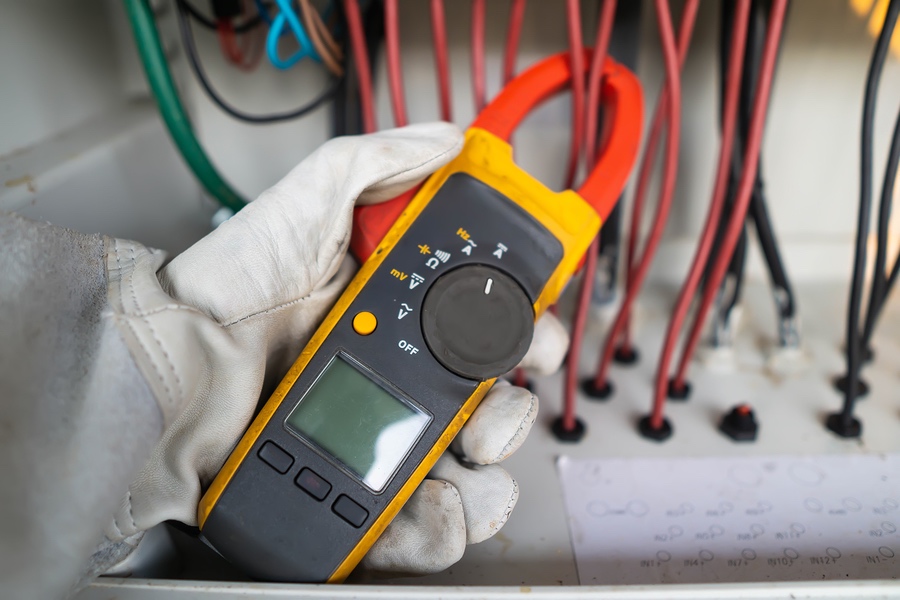

A close-up image of someone using a clamp meter.

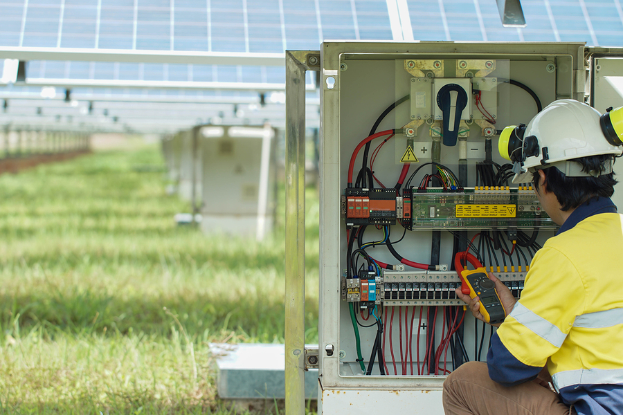

Engineer using clamp meter to measure the current of electrical wires produced from solar energy.
