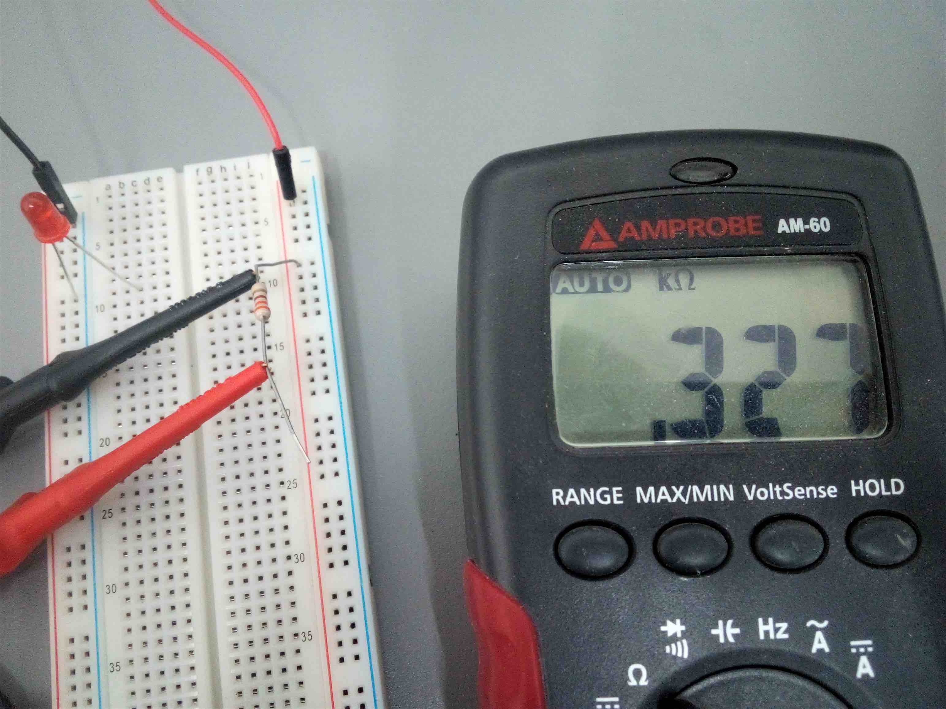

A resistance test placed on a power resistor verifies that the printed value is correct. This resistor is also rated to withstand 5 watts of power dissipation.

To guarantee proper readings, try to remove at least one connection of the resistor, isolating the component from the rest of the circuit.
