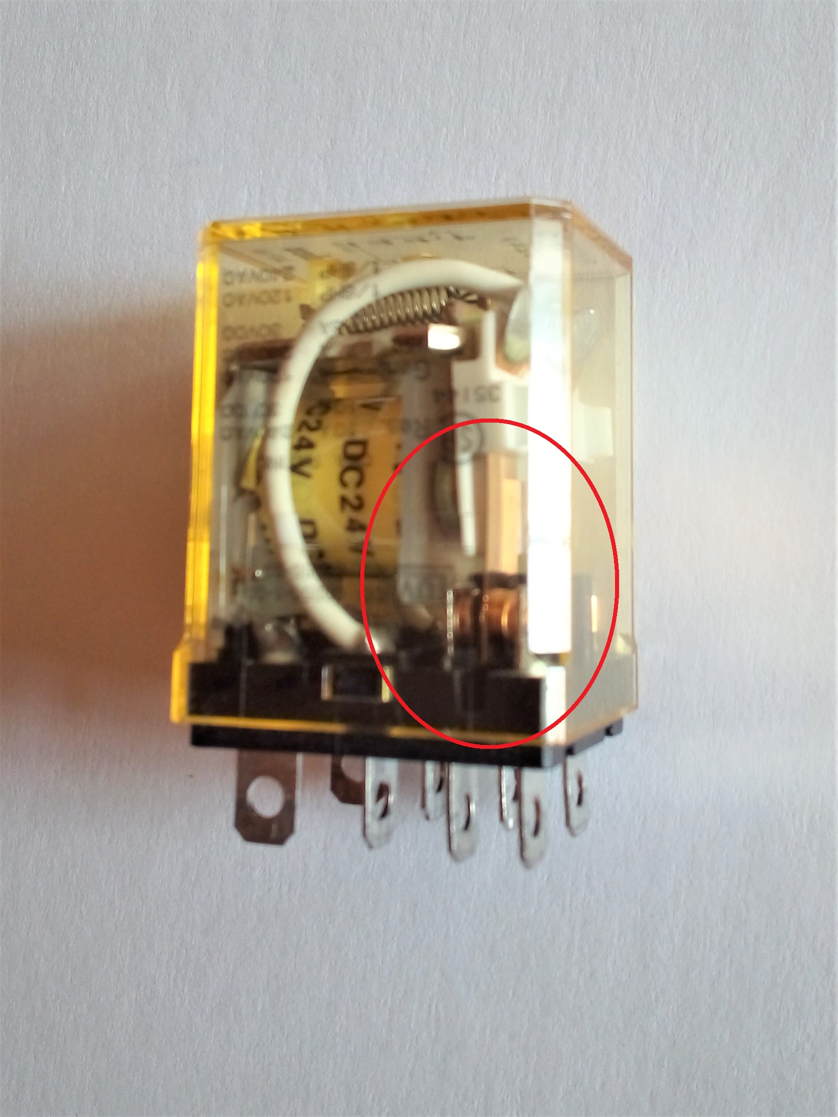

A close-up view of the contact pads on a mechanical ‘ice cube’ relay. This relay is nearly new, but a damaged contact may show black marks on the contact pas or even on the plastic case.
The other cause of failure is an electrical failure caused by an excessive number of switching actions. This is different than the mechanical failure of broken parts that may be experienced in a mechanical relay, although this is uncommon.
The electrical failures result from repetitive switches, which cause small arcs on the contacts. Eventually, the low resistance plating will corrode, causing higher resistance. This is evidenced by black marks on the contact pads and excessive heat from the higher-than-normal voltage loss. Higher voltages will cause this corrosion to occur more quickly.

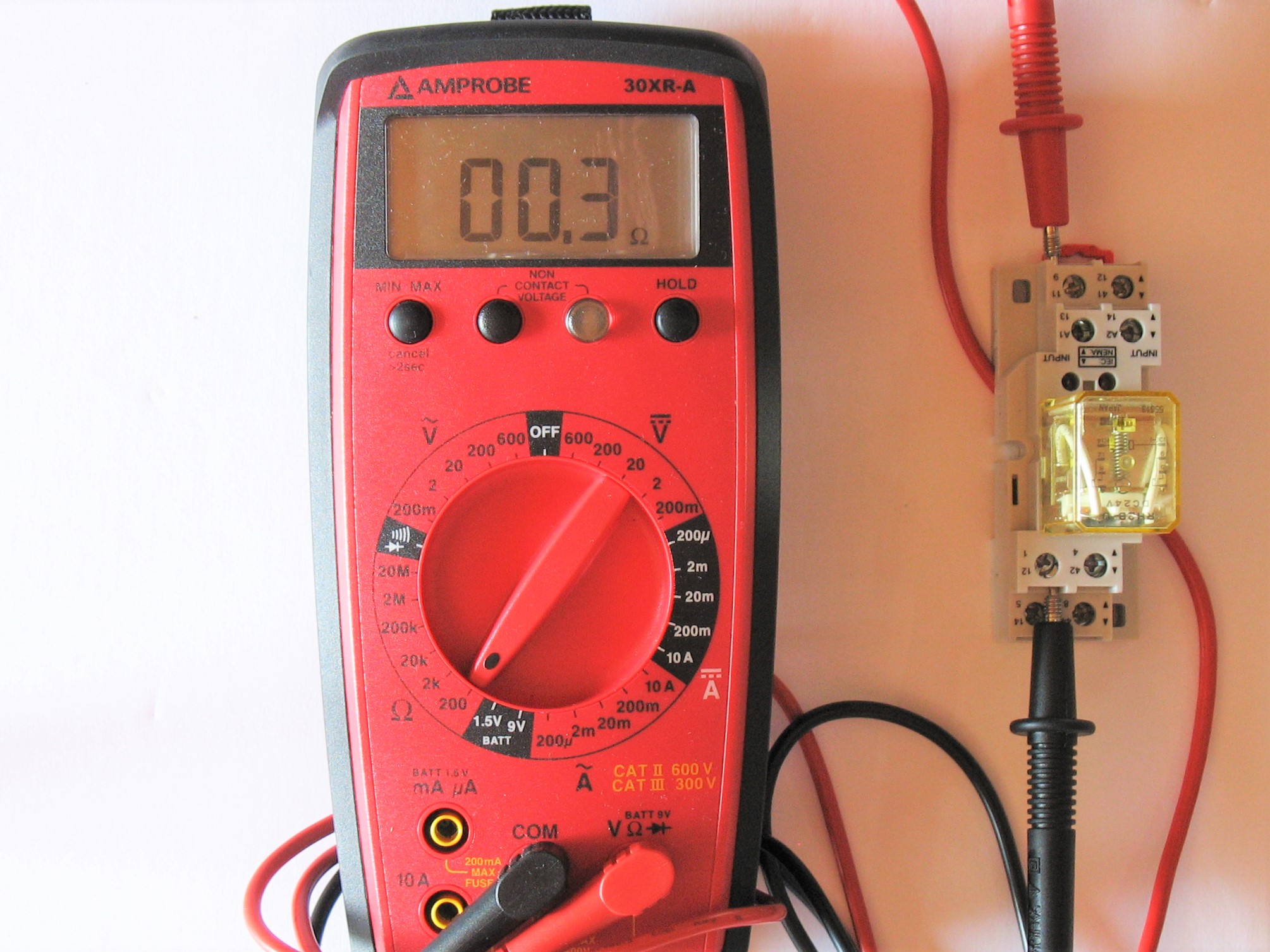

Make sure you test your multimeter leads before making a determination - the resistance of just the leads alone may be close to 0.5 ohms, this would affect your readings significantly! If the resistance of a closed contact is above the upper tolerance limit, it could result in too much voltage loss and heat dissipation in the contacts. Old, well-used relays will show an increased contact resistance, especially if they have been used to switch 110 volt AC loads.
Many multimeters will not be able to measure resistances that low, so it can be difficult to judge in those cases. However, a test of voltage in a live circuit across the contacts will show the millivolts lost by the contacts. Compare this voltage drop to that of a known working relay in a functional circuit in order to make a better measurement.
A sample ohmmeter measurement of a normally closed contact. This meter is not precise enough to measure 0.05 ohms, and also it shows the additional resistance of just the leads.
In these cases, it might be necessary to measure the small voltage drop in an active circuit to troubleshoot the relay.
