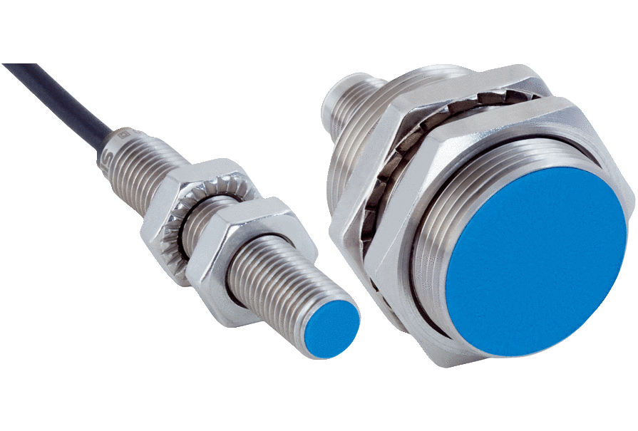

Inductive proximity sensors create an electromagnetic field close to the sensor that can detect ferrous metals within the zone. Infrared, ultrasonic, and laser-based proximity sensors use feedback from sent signals to determine if an object is within the field of range.

Proximity sensors are used in many different applications. They tell the controller when something has changed in the system by analyzing whether an object is within their sensing zone or not. Some sensors have a set zone that can not be changed, so the location of the sensor is used to determine the zone.
proximity sensor
Inductive proximity sensors. Image used courtesy of SICK Sensors
Other proximity sensors can be adjusted programmatically within a certain zone. The design of the system determines which sensor is needed for each application.

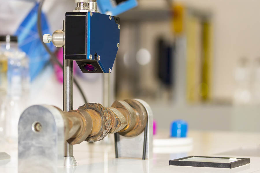

Distance sensors are programmable proximity sensors that give a readable distance signal.
They are more expensive than a traditional proximity sensor but offer more functionality in certain scenarios. They typically use a laser sender and receiver in the same unit which pulses light to gauge how far something is by how long it takes for the light to return from the sender to the receiver in the unit.
They have the capability of being extremely accurate over relatively long distances. The price of the unit usually dictates the accuracy and range of the sensor with pricier units being more accurate and having a longer range. The units can send either an analog or digital signal to the PLC/Controller to be analyzed and used in the system.
distance sensor
Distance sensor for industrial applications.
Distance reading sensors have many different applications; they can be used to measure bin/tank levels that alert operators when to change out consumables in the manufacturing process or used to give feedback to a PLC controlling certain movable parts in the system.
