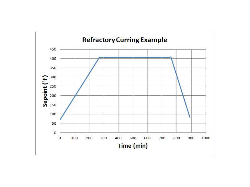

The “ramp” portion of the ramp/soak controller is used to control the setpoint of a controller in a way that could minimize abrupt changes in setpoint by “ramping” the setpoint from the current value to the desired value at a specified rate or within a specified amount of time.
The “soak” portion of the ramp/soak controller is used to control how long the setpoint will remain at the given setpoint.
ramp soak graph
Simple ramp/soak refractory curing example.
Typically a ramp/soak controller will have multiple “steps” available to be set by the operator or engineer of the system.
By having multiple steps, the controller can change the setpoint through several phases of the process without the intervention of an operator.
Example of a Ramp/Soak Controller
For example, suppose the refractory of a vessel needed to be cured/baked at 400 °F for eight hours and the manufacturer specified that the temperature of the refractory could not change more than 75 °F / hour until the refractory was fully cured.
Once cured, the refractory could be allowed to cool at a maximum of 150 °F/hour. To accomplish this without a ramp/soak controller, one would have to manually manipulate the setpoint of the temperature controller over the entire curing/baking process.
This would tie up an operator for the entire curing process and the accuracy of the control would be dependent on the diligence of the operator.
Alternatively, a ramp/soak controller could be programmed with the given criteria and left to run unattended with a great degree of accuracy, freeing the operator to attend to other tasks.
