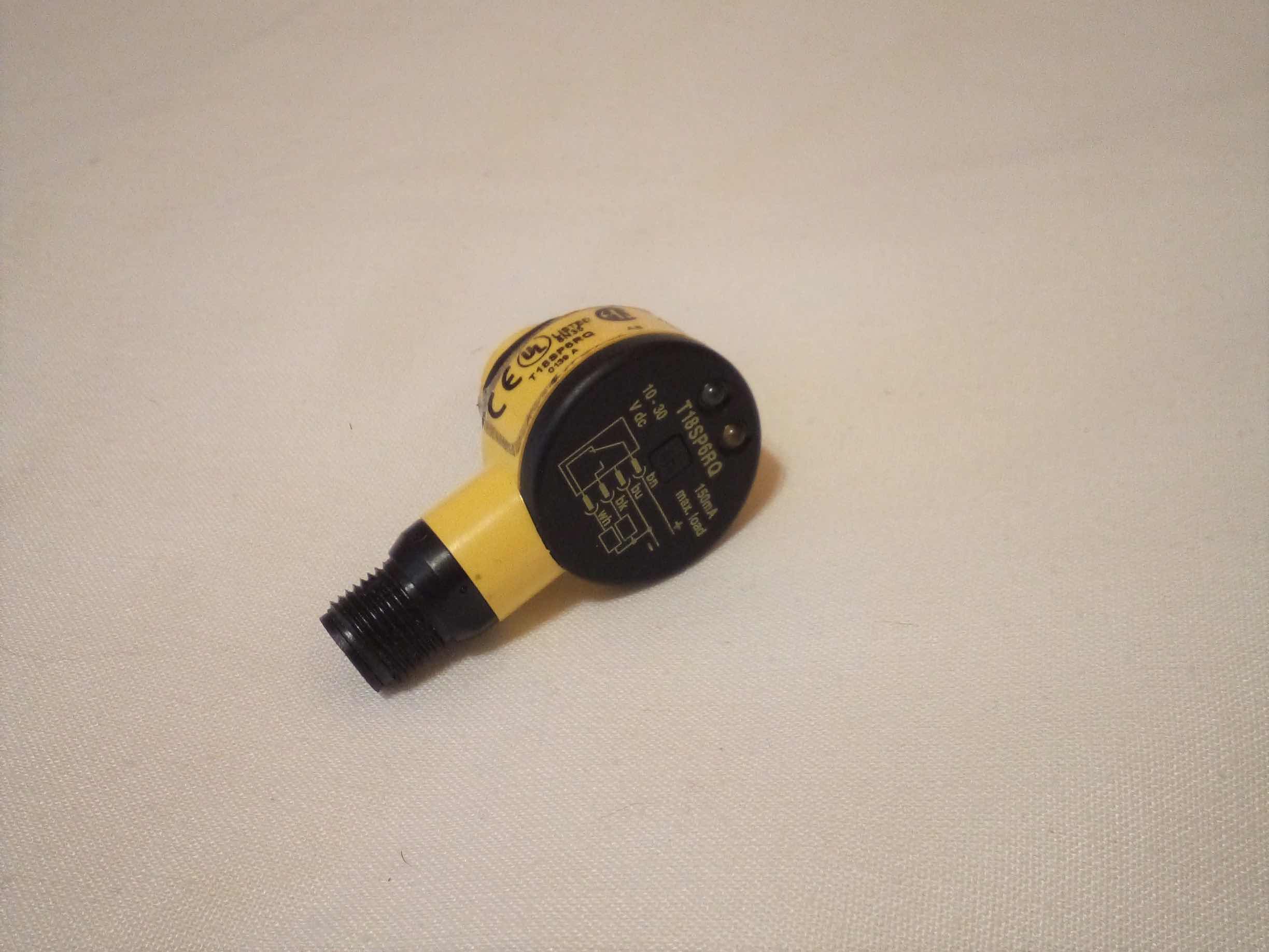

pnp output sensor
A typical DC supplied, PNP output photoelectric sensor with outputs for both Normally Open and Normally Closed operation.

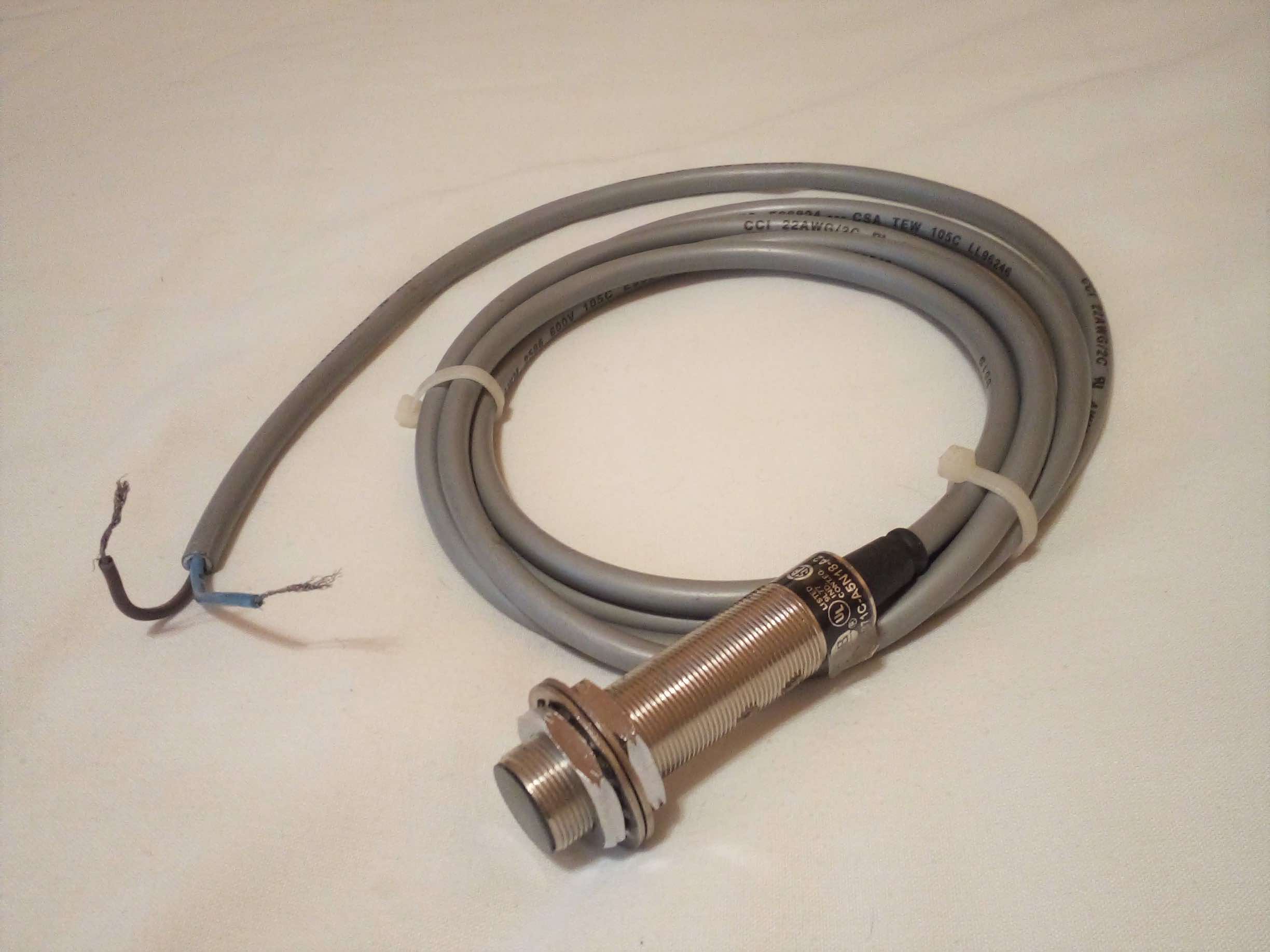

AC powered sensor
An AC powered sensor designed for sensing metallic objects through induction.
Note the blue and brown wires typical of an AC sensor, but DC-powered sensors sometimes have the same colors.
Some simple DC sensors, such as buttons and limit switches, also do not have any specific polarity, and as long as a supply wire enters one side and returns out the other side, the load device will be activated.
These sensors can also have the same brown/blue wire harness as AC, so be careful to read datasheets.
  • These 2-wire DC buttons and sensors can be used with any DC input module - they are not limited to a specific polarity. Although they are simple to connect, they usually lack the sensing capability of other sensors and are only appropriate for basic object detection.

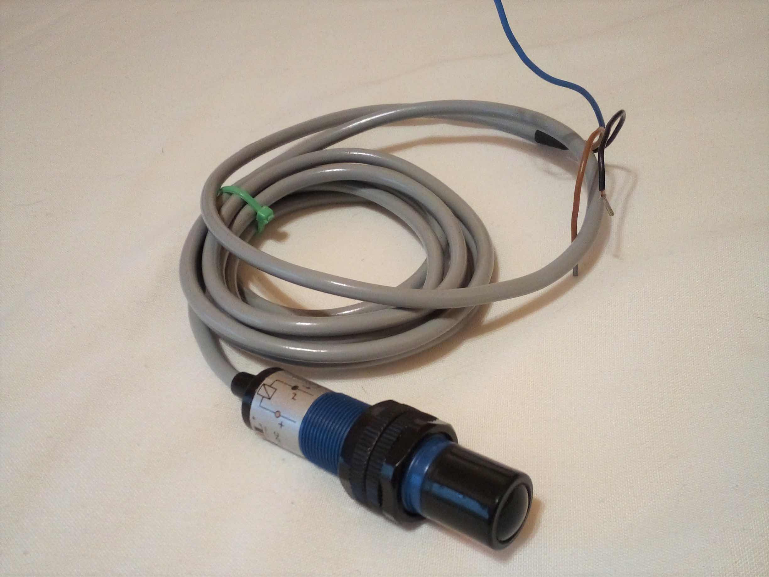

A common style of a photoelectric sensor with only one output - a PNP Normally Open control signal.
The function of both types is to complete a circuit when the desired set point is reached. The difference lies in which direction the current must travel.

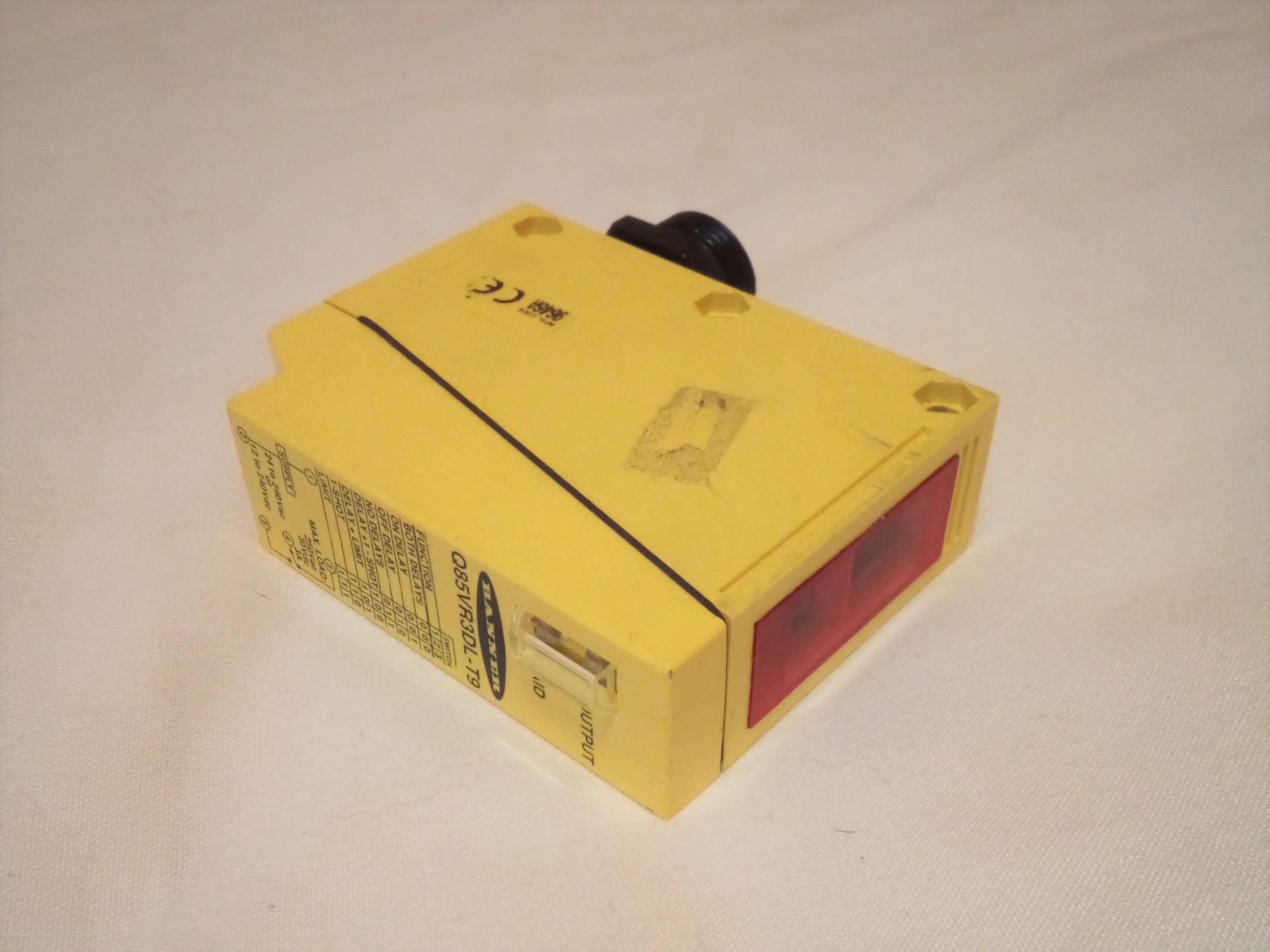

a long distance photoelectric sensor
A long-distance photoelectric sensor with Normally Open and Normally Closed outputs.
Unlike many sensors, this model has an electromechanical relay output, so it can be either Sourcing or Sinking.
