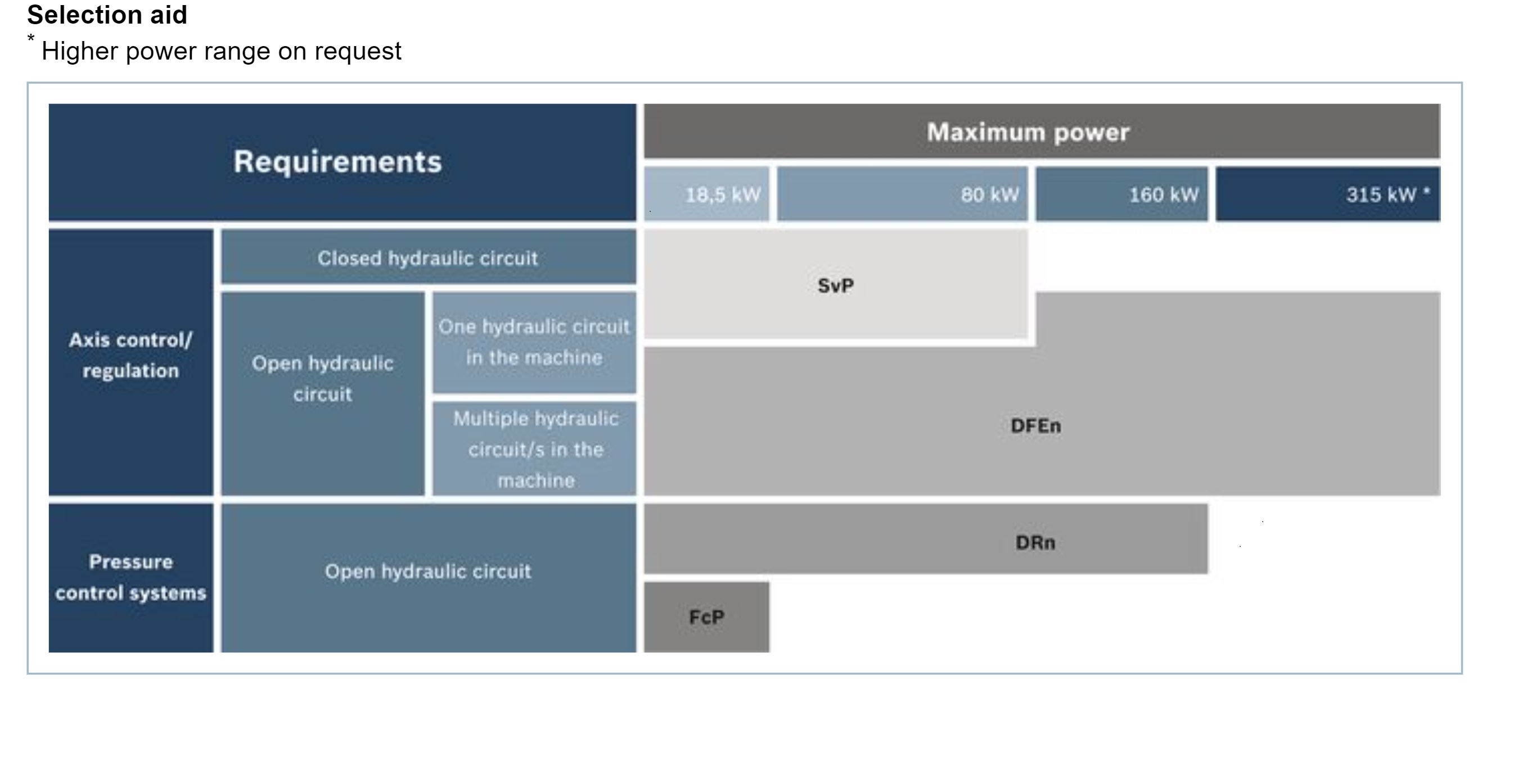

In the hydraulics sector, Bosch Rexroth has Sytronix, a series of variable-speed pump drives. Combined with electric motors, hydraulic pumps, and frequency converters, these drives can reduce energy consumption by continuously adjusting motor speeds to match the machine's requirements.
Table
Figure 1. The Sytronix drive models SvP, DFEn, DRn, and FcP capabilities. Image used courtesy of Bosch Rexroth
Figure 1 shows the Sytronix drive's capabilities to determine if a model would fit your application. Some hydraulics are matched to the same type of servo motors found in electromechanical solutions. This pairing gives hydraulics new features, precision, and control not traditionally associated with fluid power.
The system's flow capacity results from the speed of the electric motor and the setting of the pump. A pressure sensor measures the system pressure and sends it to the controller. The machine control transfers the pressure or flow command values to the controller during ongoing operation. On the basis of the control deviation, an integrated PID controller can calculate the required motor speed and adjust it according to the existing system requirements for flow and pressure.

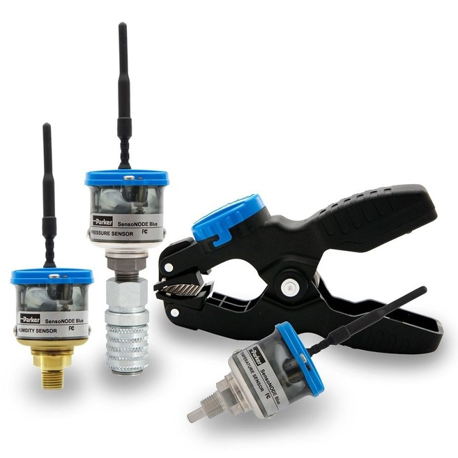

Applications can also keep equipment data at the employee's fingertips. Products such as SensoNODE can access data to monitor a system. Five low-power sensors monitor pressure, humidity, and temperature. This information can be sent directly to the user's smartphone.
Paker Hannifin sensor node technology
Figure 2. SensoNODE wireless sensors with mobile software for condition monitoring. Image used courtesy of Parker Hannifin
The app is designed to trend, assess, and monitor machine health. Continuous monitoring can improve preventative maintenance to help extend machine life. Predicting failure before it occurs eliminates costly downtime and reduces unnecessary maintenance routines.
