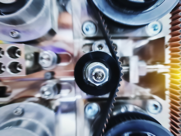

Inside nearly every machine, a selection of gears, belts, and chains send power to the final mechanisms.
Figure 1. Inside nearly every machine, a selection of gears, belts, and chains send power to the final mechanisms.

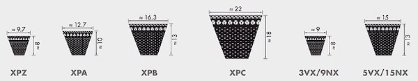

  • V-belts with a mostly trapezoidal profile. These belts are usually made out of rubber or polyurethane. Many belts, called serpentine belts, are several small v-belts side by side.
v-belt profiles
Figure 2. Common v-belt profiles.
