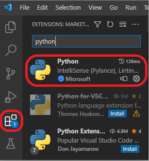

Once the download is complete, we will open the VS Code application. Upon startup, we will need to download Python for VS Code. Official documentation on this process can be found here. However, it can simply be installed by selecting the extensions button below and downloading “Python” published by Microsoft below:
Figure 2. Python extension in VS Code. Image supplied by author

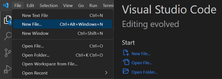

To create a new file, we will select “File > New File…” very similar to a Microsoft word document. Another method to create a new file is selecting the new file button in the central window:
Figure 3. Two methods of new file navigation in VS Code. Image supplied by the author

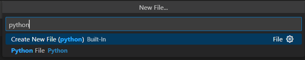

Upon being prompted which file type to create, type in “python” and select the built-in file format:
Figure 4. File type selection. Image supplied by author

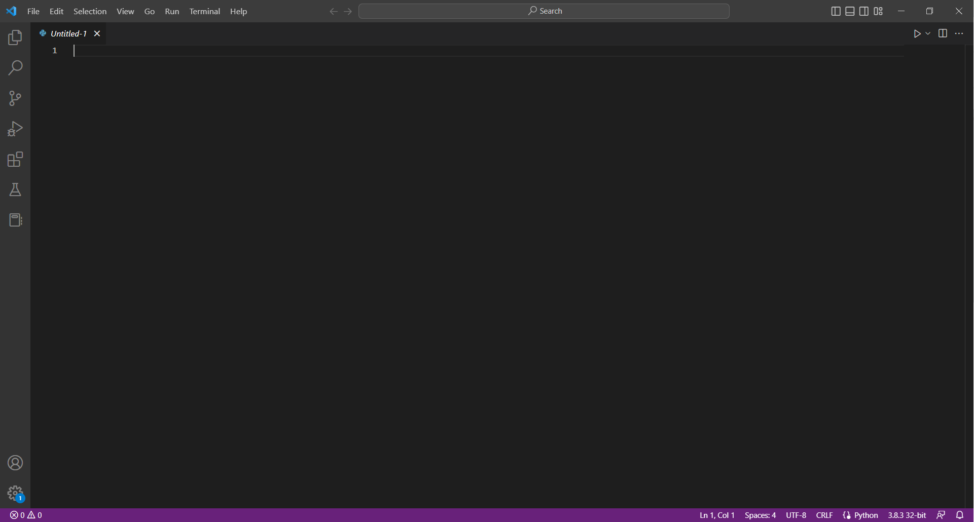

We will now have a blank canvas and a tab named “Untitled-1” with a blue Python logo similar to the one below:
Figure 5. The VS Code environment with a new “Untitled-1” Python file. Image supplied by the author

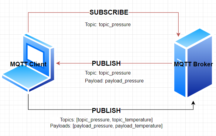

From a big-picture overview, our client is shown both publishing and subscribing to the broker below:
Figure 6. The architecture of the solution developed in this exercise. Image supplied by author
