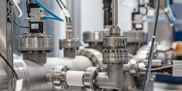

fluid dispensing
Figure 1. High precision fluid dispensers require precise and accurate measurements. Image courtesy of Michael Jarmoluk.

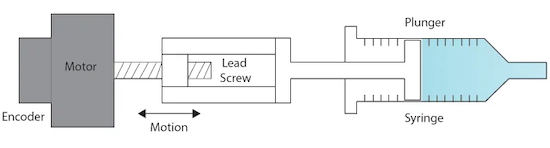

Piston or Syringe Pump
A piston or syringe pump is the most commonly used apparatus for high-precision fluid dispensing. As shown in the figure, the plunger of the syringe is connected to a motor using a lead screw. The motor can be moved in both clockwise and counter-clockwise directions. Fluid can be ejected or drawn into the syringe depending upon the direction of motor rotation.
syringe pump
Figure 2. General schematic of the syringe pump. Image courtesy of Precision Motion Devices
The maximum amount of fluid that can be dispensed by the syringe pump is equal to the volume of the syringe. Once the fluid is completely ejected, it needs to be refilled to dispense more fluid. If there is a need for continuous flow of the fluid in volumes greater than the volume of a single syringe pump, multiple pumps are used synchronously.
When one syringe is empty, the other starts dispensing fluid and the first one starts drawing in the fluid. When the second syringe is empty, they switch their roles. This will ensure a smooth continuous flow of fluid. In such a configuration, check valves can be used to manage the direction of flow and to ensure smooth, continuous flow.

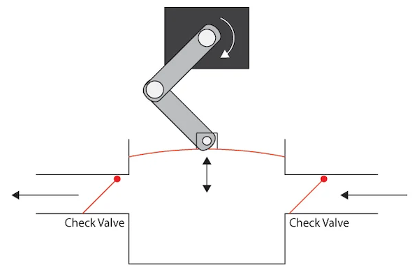

Diaphragm Pump
The diaphragm pump is a variation of the syringe pump. Here the piston for the mechanisms moves in a reciprocating manner like the pistons in an automobile engine. This displaces the liquid in the chamber. It can be used in conjunction with check valves to ensure flow in one direction.
General schematic of the diaphragm pump
Figure 3. General schematic of the diaphragm pump. Image courtesy of Precision Motor Control.

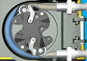

Peristaltic Pump
Another design for the precise displacement of fluids is the peristaltic pump. It is used in instances where the fluid to be dispensed is highly sensitive to contaminants.
peristaltic pump
Figure 4. A look at how peristaltic pumps work. Gif courtesy of Njmcca for Watson-Marlow. [CC BY-SA 3.0]
In peristaltic pumps, a roller squeezes liquid in a flexible tube, as shown in the figure above, and displaced the fluid in the direction of movement of the roller. In both syringe pump and diaphragm pump, the plunger comes in contact with the fluid to be displaced and has the potential to contaminate the fluid. This possibility is eliminated in peristaltic pumps. Due to this advantage, it is widely used in medical and chemical applications.
