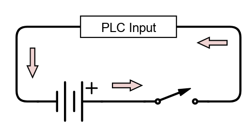

Before we investigate the transistor terms of NPN and PNP, the figure directly below shows a sinking PLC input, we can see that voltage will be switched on or off by the switch, which the PLC will recognize as the input ON or OFF.
Sourcing switch with a sinking PLC input wiring diagram
Figure 1. The simplified version of a sinking PLC input using an electromechanical switch to supply current (no transistor yet). Image used courtesy of Control Automation

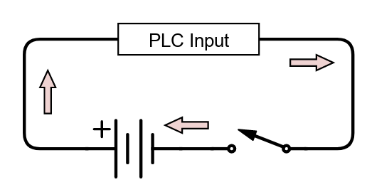

The next figure shows a sourcing PLC input, and we can see that the ground or common connection is going through the switch instead of the power.
It is important to note that the same switch can be connected in either scenario. The switch itself is not limited to being either sourcing or sinking.
Sinking switch with a sourcing PLC input wiring diagram
Figure 2. The simplified version of a sourcing PLC input using an electromechanical switch to supply the common return path (no transistor yet). Image used courtesy of Control Automation

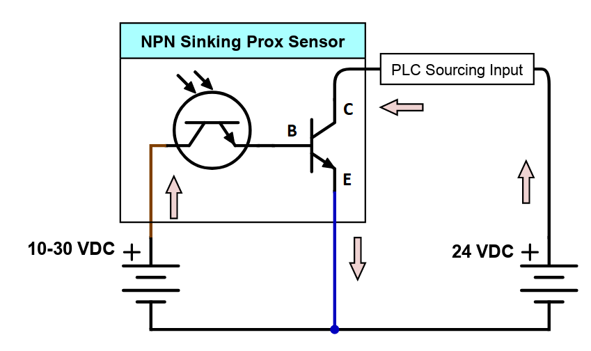

These terms are commonly used with sensors or relays, defining how the device needs to be wired. When activated, an NPN sensor will enable a path to ground (DC common return). If we look at a transistor with a base (B), emitter (E), and collector (C), current will flow from the collector to the emitter when enough positive current is present at the base.
This example shows how an NPN optical photoelectric sensor may provide the required current when a certain wavelength of light (usually of adjustable intensity) is presented to the sensor. The PLC supplies the signal wire current, and a small amount of current will flow to the blue wire when the sensor is energized. The module will recognize this as an 'energized' or 'true' signal.
What's inside an NPN sensor, or what's inside a sinking sensor?
Figure 3. Circuit diagram of an NPN sinking sensor showing the well-recognized 3-wire sensor connection colors and the sourcing PLC module. Image used courtesy of Control Automation

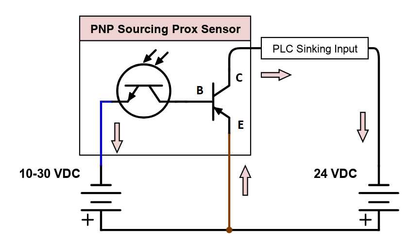

A PNP sensor works oppositely—when the sensor is activated, the signal terminal will have voltage; when the sensor is not active, the signal will be zero volts. The same is true with transistors. With a PNP transistor, current will flow from the emitter to the collector and the base when the base is provided with a path of sufficient current.
Because the sensor's function changes depending on whether the sensor is PNP vs. NPN, it is very important to know what type of sensor you are using. Since the internal construction of a transistor is two opposing diodes, current from the PLC cannot flow if the wrong kind of sensor is used. Therefore, if the wrong sensor type is used, the signal will always appear as 'false' or 'low'.
What's inside a PNP sensor, or what's inside a sourcing sensor?
Figure 4. Circuit diagram of a PNP sourcing sensor showing the well-recognized 3-wire sensor connection colors. Image used courtesy of Control Automation

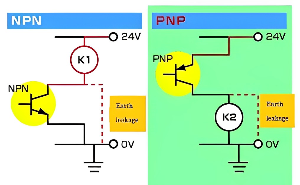

When considering an output module, safety systems, or motion devices that could cause harm, we should use PNP outputs or sourcing-style relay connections because of the possibility of unexpected motion. This is closely related to the concept of power-side and ground-side switching.
With an NPN device, the scenario of the signal connection finding a ground would activate the device. This means if the cable wears away and exposes the signal wire, and that wire happens to ground itself out, you could have unexpected motion as the device controlling the motion would be bypassed. This could happen while people are inside guarding and working on equipment. Some might argue that switching negative reduces arch flash and is less wear on the contacts. While this may be true for larger current circuits, control circuits typically use low voltage, ~24 VDC, and low current.
Comparison of NPN and PNP outputs and what might happen if a fault (red dashed line) were to occur.
Figure 5. Comparison of NPN and PNP outputs and what might happen if a fault (red dashed line) were to occur. Image used courtesy of Omron Automation
In the safer version using a PNP (sourcing) module to control a sinking load, the case of a grounded signal wire would bypass the load, not the control. There may be some overcurrent damage to the control module, but the motion device will not be activated, and a higher degree of safety is achieved.
