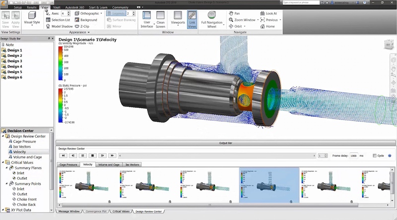

Figure 2. Flow simulation illustrates the flow of fluid particles through a system as they interact with solids, other liquids, and heat. Image used courtesy of Autodesk

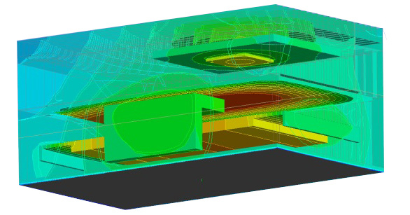

Figure 3. CFD finds extensive application in thermal management of electronics, as in this example of a modular chassis used for mission-critical applications. Image used courtesy of ANSYS

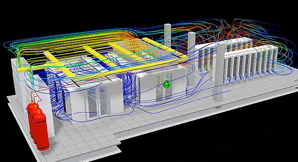

Figure 4. CFD can optimize data center energy efficiency, providing information about key characteristics such as the cooling airflow needed to keep temperatures under control. Image used courtesy of Autodesk
