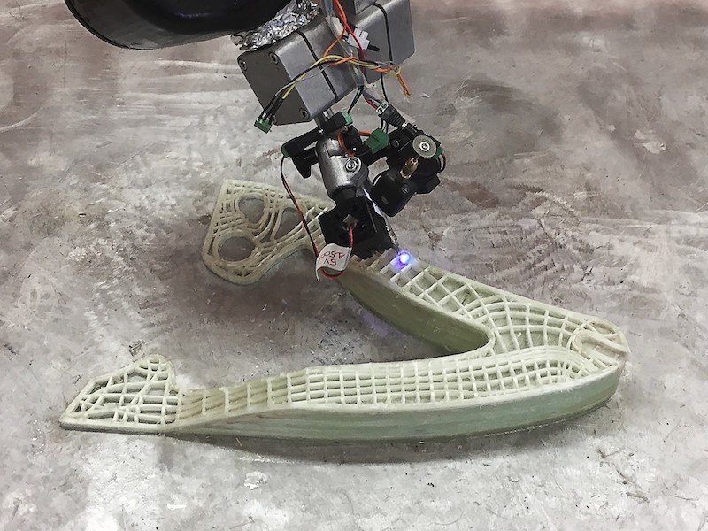

CFM is achieved by using a six-axis robot arm (such as KUKA and Comau robots) outfitted with the necessary tooling to lay continuous fiber, deposit and cure the matrix material, as well as to apply pressure and cut the fibers.
How is Continuous Fiber Manufacturing Different From 3D Printing?
CFM prints both fiber reinforcement and polymer matrix material to create composite parts through the automated layup of reinforcing fibers and the matrix material in a deposition process similar to 3D printing
There is, however, a key difference: Unlike 3D printing, where the components are built up layer by layer, CFM uses a six-axis robot. The robot additively manufactures the components in multiple dimensions to lay the continuous fibers along non-linear axes.

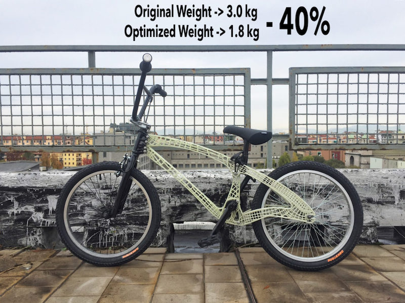

One of CFM’s key benefits lies in its ability to optimize both the weight and structure of a component. An excellent example of this lies in the bike frame shown in figure 3, which achieved a 40% reduction in weight while still maintaining the necessary strength and stiffness to effectively serve as a BMX bike frame. Strength and stiffness are obtained through the layup of the continuous glass fibers embedded in the UV curable resin epoxy.
moi composites bmx bike frame cfm
Figure 3. This BMX bike frame was manufactured using CFM technology, where the combination of directional fibers and UV cured epoxy reduced the weight without compromising strength and stiffness. Image used courtesy of Autodesk
