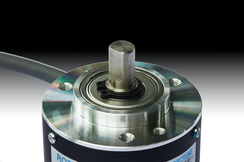

What is a Rotary Encoder?
A rotary encoder is an electro-mechanical device that gives feedback. This feedback is in response to the motion of the position of the attached mechanical assembly (in most cases, it is a shaft). Encoders are widely used in the industrial sector and their basic use is in controlling rotary movements.
Closeup of a rotary encoder
Figure 1. Closeup of a rotary encoder
The encoder gives output every time the assembly moves in a circular direction. The output is in the form of electrical signals. Depending on the type of encoder, the output can be a series of pulse trains or a fixed value that can be used for any type of task.
The output of the encoder must be connected to a controller or any interface circuitry to make use of its signal. It can be used to calculate speed, count, or position of the attached assembly.

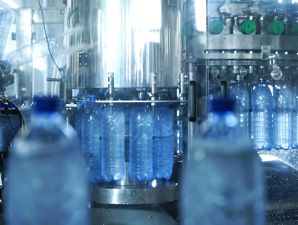

Volume Control in Filling Applications
Incremental encoders are used to monitor and control the volume of liquid in a container. The encoder in this application is used as a counter.
The Encoder is attached to a rotary pump and the volume of liquid is calibrated by counting the pulses received from the encoder. The specific number of pulses represents the specific volume of a liquid.
Figure 2. Incremental encoders are used to monitor and control the volume of liquid in a container.
The pulses from the encoder are compared by the reference number of counts. When the count received becomes equal to the reference count, the controller stops the pump and the container is transported to the next stage of the operation. This process is repeated for the next container.

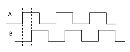

Direction Control
As mentioned above, incremental encoders have three outputs. Two outputs are terminal A and terminal B. Both of these outputs are 90 degrees out of phase with each other.
90-degree out-of-phase signal A and B
Figure 3. 90-degree out-of-phase signal A and B
Monitoring these two outputs allows us to control the direction of the attached assembly. For example, if signal B arrives before signal A, we can trigger an alarm and stop the system, as compared to normal operation where signal A arrives before signal B.

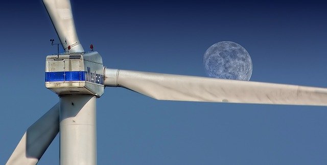

Wind Turbines
Absolute encoders are used in wind turbines to optimally position the blades to maximize output from the wind. The absolute encoder has the responsibility to remember the position of the wind blades. This position is also remembered even after power is shut down.
Absolute encoders are used in wind turbines to position blades, maximize output, and remember position even after shut down
Figure 4. Absolute encoders are used in wind turbines to position blades, maximize output, and remember position even after shut down. Image courtesy of Peter Dargatz.
Any change in the direction of the wind is picked up by the sensors which give input to the main controller. The controller, in turn, gives the command to change the direction of the blades.
