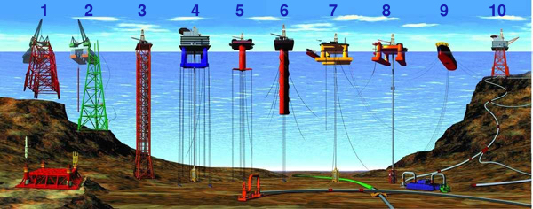

Oil and gas fields reside beneath many offshore areas around the world. In oil and gas processes, the term subsea refers to exploring, drilling, and developing oil and gas fields in underwater locations. Underwater oil facilities are commonly referred to using a subsea prefix, such as subsea well, subsea field, subsea project, and subsea development.
Figure 1. Types of oil and gas structures used in subsea oil production. 1, 2) conventional fixed platforms; 3) compliant tower; 4, 5) vertically moored tension leg and mini-tension leg platform; 6) spar; 7, 8) semi-submersibles; 9) floating production, storage, and offloading facility; 10) subsea completion and tie-back to host facility. Image used courtesy of the National Oceanic and Atmospheric Administration
Current technology allows for subsea development at a water depth of 12,000 feet. There are more than 1,300 jack-up rigs and semi-submersible platforms worldwide, in which over 170 active rigs are located near the southern coast of the United States in the Gulf of Mexico. Global offshore oil production accounts for nearly 30% of total global oil production and produces at least 28 million barrels of oil per day.

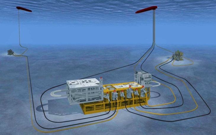

Subsea production systems can be as simple as a single satellite well with a flow line connected to a fixed platform. This can be done simply with floating production storage or as complex as installing multiple wells clustered around a manifold and transferring to a fixed or floating facility or directly to an onshore installation.

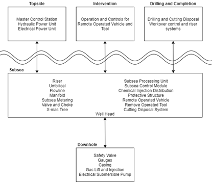

Subsea Control Modules and Components
A subsea production system is divided into the following typical subsystems:
  • Well head, X-mas tree with valves and chokes, and workover control and riser systems.
  • Production control system including the subsea control module (SCM), chemical injection distribution system, underwater X-mas instrumentation. On the offshore platform, it includes the master control station, distributed control system, hydraulic power unit, and electrical power unit.
  • Subsea umbilical, which includes the electrical, hydraulic, and chemical lines with terminations.
  • Intervention systems include the tools for pull in and connection of umbilicals, tools for running choke, control pod, pig launcher, umbilical winch, and heave compensation equipment.
  • Subsea structures and piping systems, which include the template and satellite structures, manifold, and riser base structures, protection structures, and piping modules.
  • Subsea flowlines, which include the hard pipes, flexible lines, and rigid and dynamic risers.
  • Subsea processing unit for metering, boosting, separation, and water injection.
Figure 3 below demonstrates the system architecture for a typical subsea production system.
Figure 3. Subsea production system block diagram
