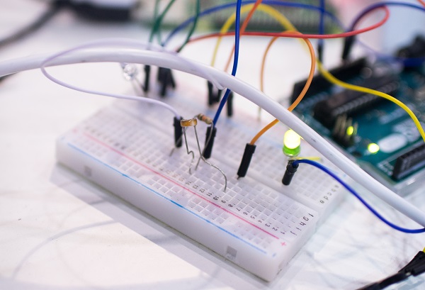

When you begin a STEM or engineering education, you will likely begin your journey of programmable controls using microprocessors, like the common Arduino or Raspberry Pi platforms, before PLCs appear on the workbenches. Those microprocessors always make use of analog voltage inputs, usually in the range of 0-5 or 0-3.3 volts.
Arduino with analog voltage divider
Figure 1. A light-sensing (photoresistor) voltage divider circuit on an Arduino platform. Note that just two inexpensive components are used. A constant-current source would be far more difficult to construct. Image used courtesy of Adobe Stock
Thus we begin our career understanding how to measure variable voltage across a voltage divider, and this becomes cemented as the standard process for connecting analog inputs.

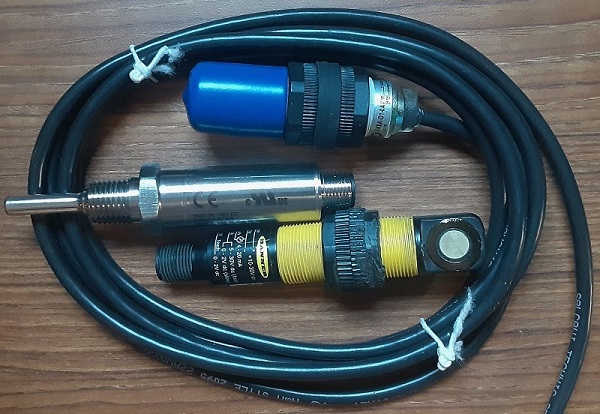

A variety of analog sensors
Figure 2. Several sensors can be seen with an analog voltage or current output. Often, this fine print is indeed very small on the side of the sensor. Author’s image

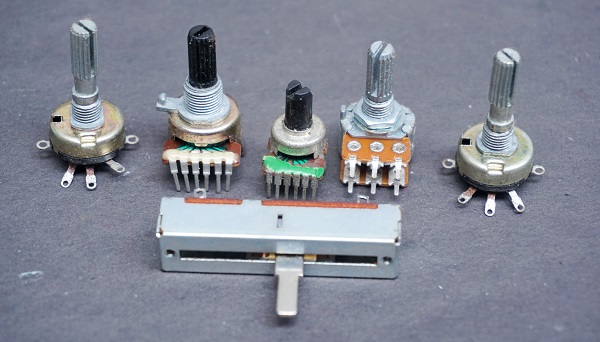

Previously, we discussed those small microprocessors using voltage dividers to read a changing signal, and it’s because they are cheap and easy to create. This is perhaps best illustrated in the potentiometer, a common industrial rotary knob for adjusting motor speed, set points, and other properties. It can be connected to an analog controller with only 3x wires and no extra components. Converting this device into a constant-current analog signal would be difficult and time-consuming.
Most transducers (devices that convert physical properties into electrical signals) will vary the current or resistance passing through a circuit. If this is not conveniently in the 4-20 mA range, it requires added amplifiers and regulators. On the other hand, pairing that simple transducer with a single fixed resistor can create an ideal voltage divider for 0-10 volts.
