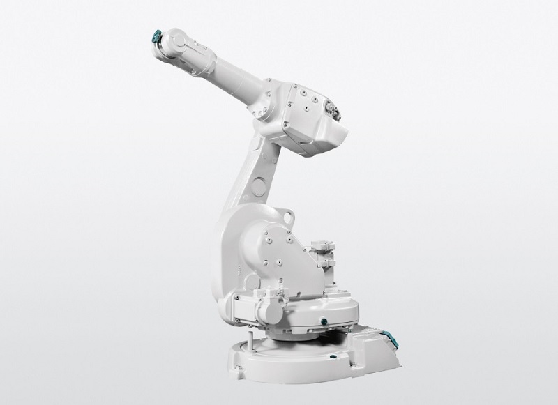

ABB IRB 1600 robot
Figure 1. ABB IRB 1600 industrial robot. Image used courtesy of ABB

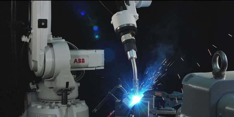

ABB robot welding
Figure 2. ABB welding robot cell. Image used courtesy of ABB

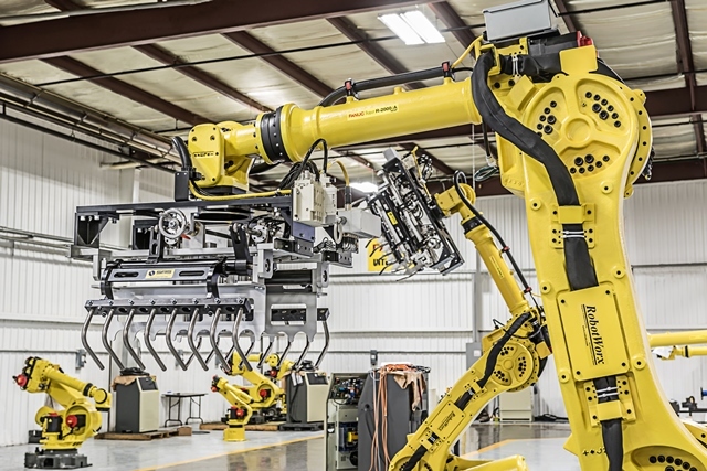

Robot grippers
Figure 3. Robots are used for handling all kinds of materials - hard, soft, large, small, heavy, and light. Image used courtesy of RobotWorx

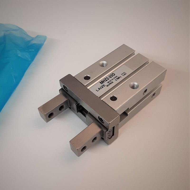

Pneumatic gripper
Figure 4. A typical pneumatic gripper used for pick-and-place and work holding tasks.

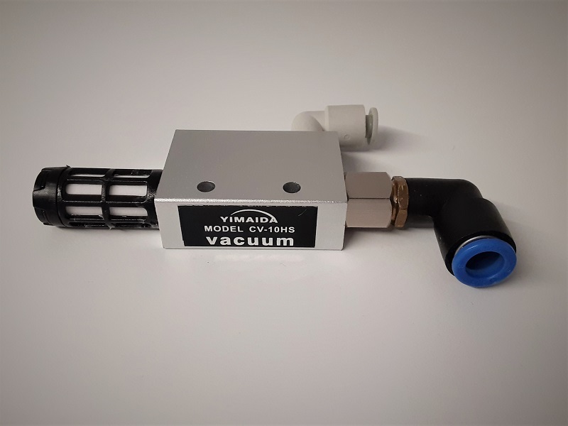

Vacuum ejector
Figure 5. Vacuum ejectors are used along with vacuum grippers to lift flat objects.
