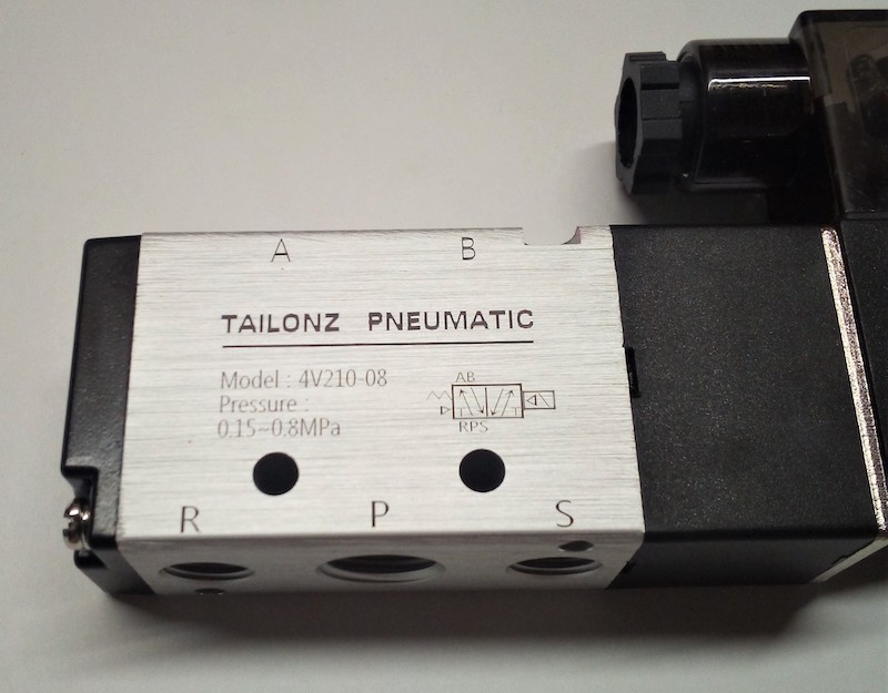

Pneumatic systems exist for one reason: to get things to move. Motion requires pushing against a load with more force than that which is fighting back. A pneumatic system is pushing on cylinders which always have an atmosphere of pressure outside pushing back. So you will always have to press with at least 14.7 psi plus an additional amount to get something to move.
Figure 1. A typical solenoid valve showing the acceptable pressure allowance of the valve. It shows between 0.15 and 0.8 MPa (mega pascals) which converts to between 22 and 115 psi, which is the allowable gauge pressure in a system that properly uses this valve.
If we are interested in the additional pressure we need to overcome the atmosphere, this is the most commonly used value. We design the gauges to show only the additional pressure above what the atmosphere is already providing. If the gauge shows 15 psi, it means 15 psi more than the atmosphere on the outside.
Mathematically, we could say that absolute pressure is always a higher value than gauge pressure, by exactly one atmosphere.
Abs Pressure = Gauge Pressure + 1 atmosphere
It’s usually safe to assume 14.7 psi or 101 kPa for that one atmosphere, but for very precise measurements, the local ambient pressure from weather patterns and altitude can change the atmospheric pressure.
Since the atmospheric pressure will always be there on both the inside and outside of the system, it’s the difference between the two that causes the air to move through the system and fill the cylinders, and eventually, go to the exhaust ports.
Datasheets will always list values and operating parameters as that difference, or gauge pressure. If a datasheet or parameter is ever meant to be absolute pressure, it will be stated, but this would be extremely rare.
Conveniently, pressure gauges are also calibrated to show gauge and not absolute values. If you turn off the compressor and open a valve to exhaust all the air, eventually it will read 0 psi. If it were showing absolute, it should display 14.7 psi.
