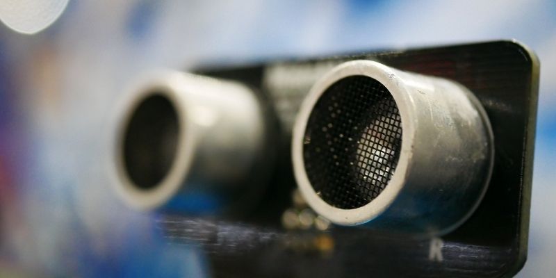

Sound sensors
Figure 2. Sound sensors are usually synonymous with microphones, sometimes arranged in arrays to triangulate sound sources. Image used courtesy of Canva
Active vs. Passive Sensors
Some sensors, such as microphones, are passive, in that they only collect signals that are generated elsewhere. There are also active sensors that generate a noise, then listen to collect the response from a workpiece. In particular, there are ultrasonic crack detectors that generate an ultrasonic signal and listen for the vibrations in the material to determine if there are cracks, as the cracks will cause the signal to distort in particular directions. Ultrasonic crack detectors such as this are especially useful for nondestructive testing (NDT) of cast parts, pressure vessels, and pipelines.
Arrays
Another method for narrowing down trouble spots is to use microphone arrays. These arrays consist of multiple microphones arranged in a known pattern. Because the spacing of the microphones is known, a well-built data acquisition system can track the timestamps of when a noise arrives at each microphone. These signals can be converted into distance measurements, and once the distance measurement from each microphone is known, the trouble spot can be pinpointed. This is similar to how seismometers determine the epicenter of earthquakes; they triangulate the position.
The downsides of using microphone arrays are that they require many microphones in a fixed arrangement and high-end processing capabilities for signal analysis. This limits the system’s portability, and such systems are typically installed semi-permanently near troublesome equipment or equipment that will benefit greatly through early detection of problems. Some interesting array designs to appear recently rely on fewer microphones, but a rotating arm to provide them with a wider field of view, such as Seven Bel’s recently-announced Sound Scanner.

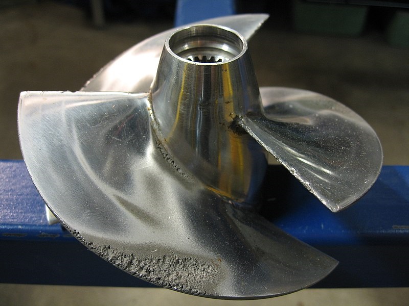

Propeller cavitation
Figure 3. Ship propeller with cavitation damage. Image courtesy of Erik Axdahl on Wikipedia
Pump Cavitation
One of the enemies of pump life is cavitation, where the pressure drops low enough to cause liquid to vaporize. The violent vaporization bubbles nick the blades of the impellers, causing them to wear much more quickly. With a unidirectional microphone, the vaporization can be heard and the pump speed or flow pressure adjusted to prevent cavitation.

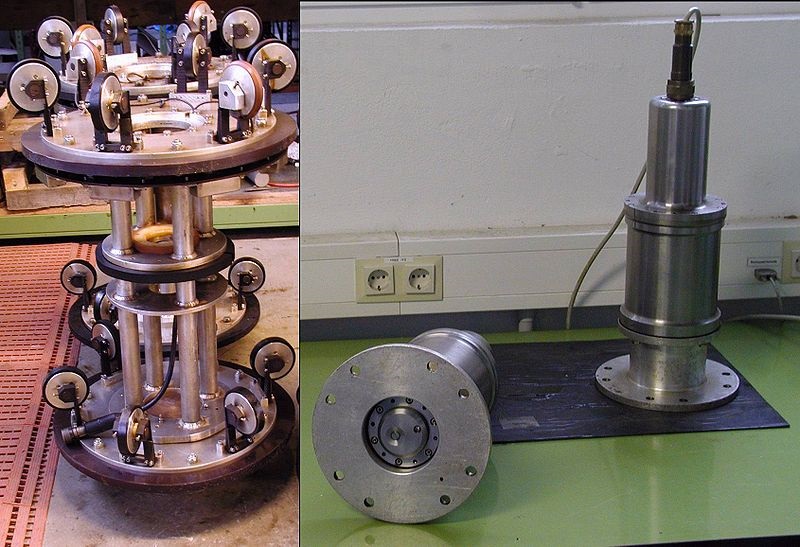

Pipeline Leaks
Ultrasonic crack sensors are often used on pipeline inspection gauges (PIGs). The PIG is inserted into a pipeline and propelled through, sending ultrasonic signals and collecting the responses along the way. The PIG is recovered and the data analyzed. Based on the response signals, thin spots from wear or corrosion can be identified before the pipeline leaks.
Pipeline Inspection Gauge
Figure 4. A pipeline inspection gauge (PIG). Image used courtesy of Wilfra on Wikipedia
