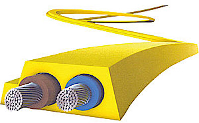

A particular feature of ASi is its wiring method. In a traditional setting, a system with many field devices will often include complex wiring and large masses of cable trees. This is completely avoided with ASi, thanks to a special two-wire cable capable of transmitting both power and data. This greatly reduces installation costs in material and workforce required.
Figure 2. The ASi cable has two wires and is enclosed by a flat self-healing material. Image used courtesy of Bihl Wiedemann

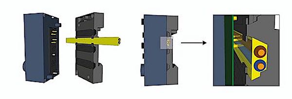

Another advantage of the ASi cable is the simplified connection process, known as piercing technology, or click-and-go. ASi-compatible devices are equipped with piercing pins designed to attach to the wires inside the flat ASi cable. The cable is provided with reverse polarity protection, and it can automatically detect newly-connected hardware into the network. Power comes from power supplies connected at one end of the ASi cable.
Figure 3. The ASi cable has two wires and is enclosed by a flat self-healing material. Image used courtesy of Bihl Wiedemann

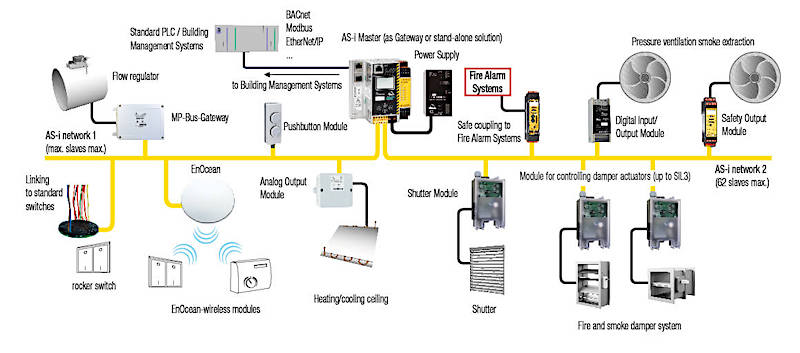

ASi systems can be categorized into three main types: compact, extensive, and multi-master.
Compact systems are standalone ASi that are not connected to any other bus. These systems can be configured in one of the following topologies: tree branch, star, and ring. The most commonly used topology is a tree branch due to the ability to add multiple branches at any cable connection point.
Figure 4. Multiple devices connected to an ASi Master in two branches. Image used courtesy of Bihl Wiedemann
In an extensive system, the ASi is decoupled and integrated with higher-level buses. Multiple ASi can connect to the same bus. This system has the advantage of extending beyond the 500-meter limit of the ASi connections.
A multi-master system implies more than one ASi master. This system is useful for maximizing cable distance, as well as the number of connected devices.

  • Building automation: Fire suppression and smoke control systems, shutter drives, and HVAC are elements of buildings increasingly using ASi, especially tall buildings where the reductions of wiring material needed are more significant.

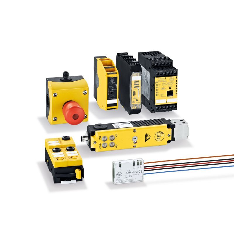

  • Safety: This is a solution ASi offers to simplify the integration of safety devices along with other field components by letting them work in parallel. Safety-rated ASi modules can then be integrated and monitored in the network.
  • Internal logistics: Large robotics systems, such as automated storage and retrieval systems (ASRS), increasingly use ASi to install field devices at long distances.
Figure 5. Safety-rated ASi devices are part of the safety at work network. Image used courtesy of ifm
