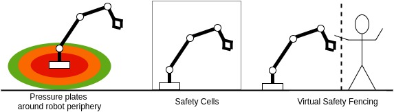

Conventional robots working since the 1980s have stringent safety measures that usually stop the robot instantly upon sensing human intervention. These security measures include virtual geofencing, pressure plates, and safety cells. These robots heavily rely on external sensing systems around the robot to detect human presence.
Figure 1. Safety aspects of non-collaborative manipulators

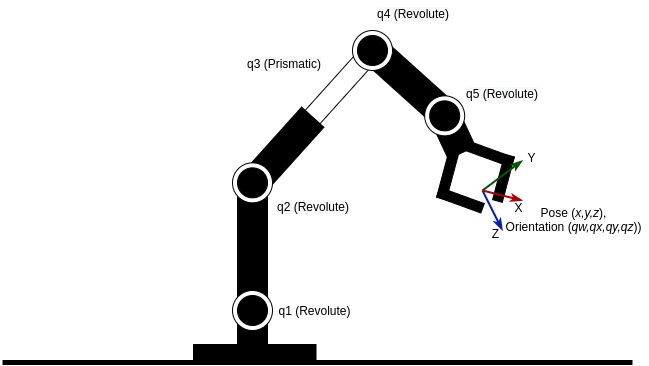

The joint position vector of the robot is defined by and the 3D Cartesian pose (position and orientation) are defined as .
Figure 2. Robot Manipulator Cspace and task space

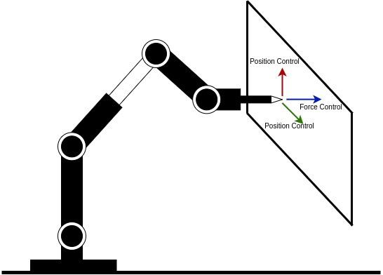

For applications where the interaction forces are small and can be accommodated by reducing tolerance in position space, an impedance controller is used. The trade-off between the position accuracy and handling interactions is determined by the stiffness in the impedance model. This means the robot can be maintained in force/position control in certain directions and tight position control in others.
For a common industrial application like deburring or etching, the end-effector needs to interact with a surface with a certain sense of compliance in order to accommodate the interaction forces. However, these interaction forces are only along the normal of the contact position while the position in the plane needs to be maintained. Thus, the Z-direction operates in force control mode (by reducing the stiffness) while the X and Y directions are held in tight position control.
Figure 3. Impedance control for an etching task

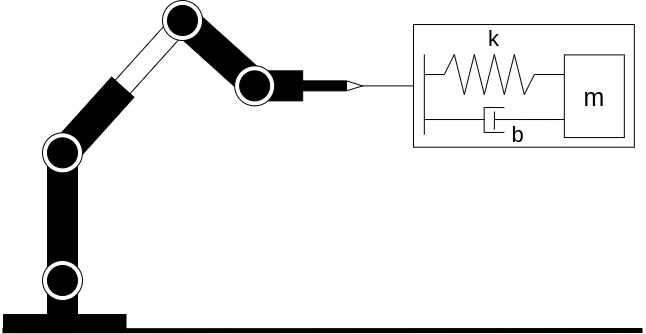

The dynamic impedance model defining the external Cartesian force F_a is designed as given below and is the basis for impedance control.
where are the mass, damper and spring coefficients while is the desired pose of the robot’s end-effector and others are its derivatives. Using the mass-spring-damper model for the external forces, and keeping slightly into the environment plane, the robot can ensure constant contact with the surface thus maintaining appropriate force interaction and satisfying position instructions.
Figure 4. Mass-spring-damper system

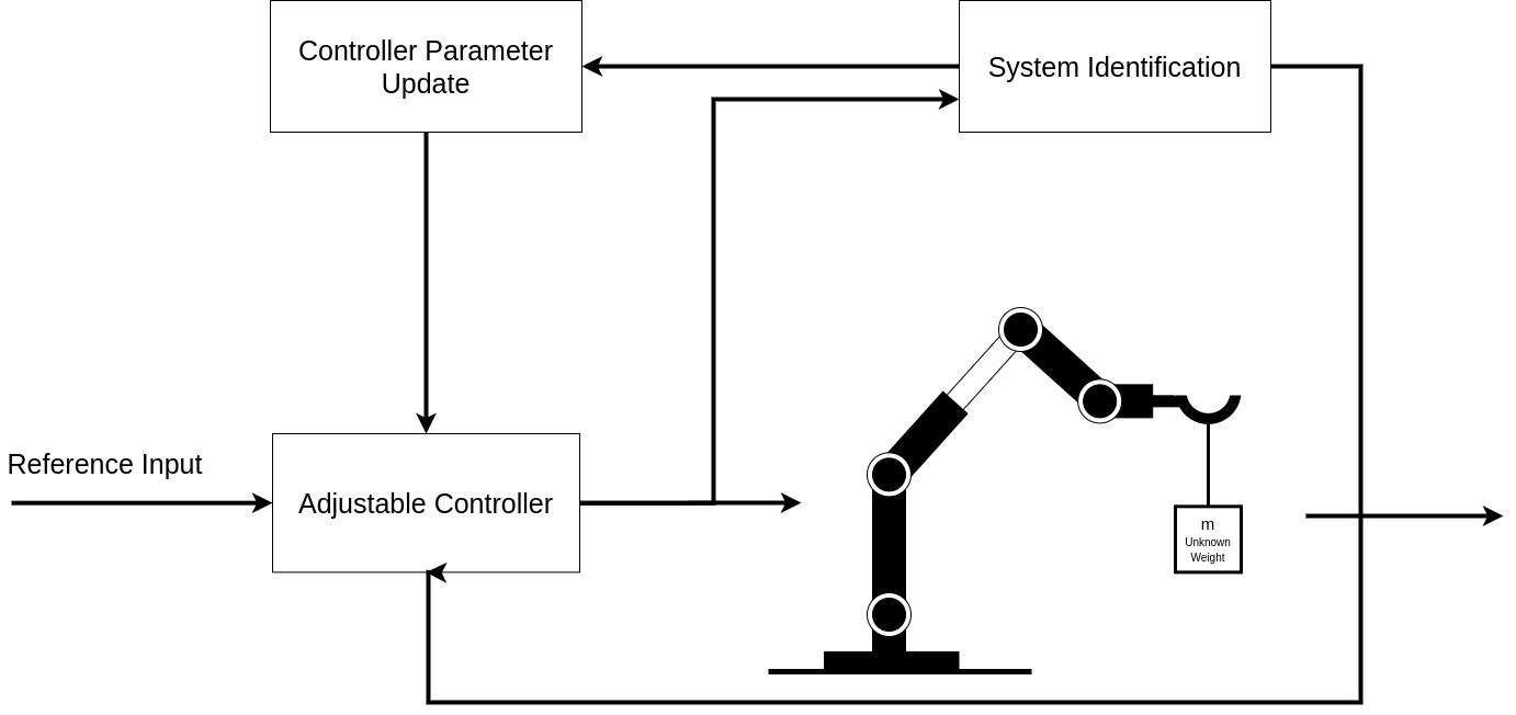

Robot arms are also supposed to work while manipulating different workpieces. Achieving satisfactory performance during actions like lifting and moving different unknown loads around, and pushing and nudging workpieces, is difficult at all times. Robust and adaptive controllers are capable of handling unprecedented and uncertain payloads for the robot, throughout its motion.
Figure 5. Adaptive Controller comparing the robot params against current behavior

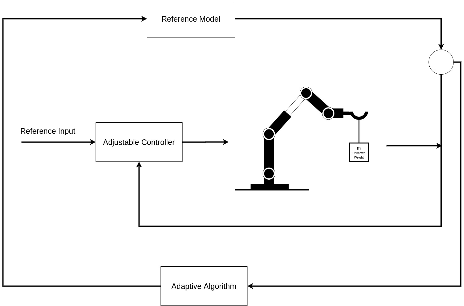

Adaptive control is one of the most suitable robot control methods to accommodate system nonlinearities and robot dynamic model uncertainties. The control technique ensures the robot is insensitive to parameter and payload variations and does not have computational overhead either.
Robust control is, however, only suitable to achieve good performance in terms of stability or tracking error, only within known and small ranges of parametric uncertainties. Adaptive control, on the other hand, is capable of adapting to the evolving variations in the system and thus implement, in layman terms, an online parameter estimation that accommodates unbounded variations. Thus, adaptive controllers are able to gradually reduce the errors over time and they eventually converge to near ideal value while robust control may be able to account for the errors, but never reduces it over time. However, adaptive controllers need to be configured for particular types of uncertainties — one meant for payload uncertainties may not be feasible for system modeling inaccuracies.
A linear adaptive controller for the robot joint torques can be defined by where x is the reference state vector and r is the reference input to the robot.
Figure 6. System Identification Analogous Behavior for Adaptive Controller
Most common robust control methods are linearization-based robust control and passivity-based robust control. Model-reference, self-tuning, and linear perturbation adaptive controllers are the most common from this category. The mathematical derivation is outside the scope of this article, but both of these controllers eventually use concepts of Lyapunov stability to derive the final additional element introduced in the dynamic equation for the robot mentioned above.

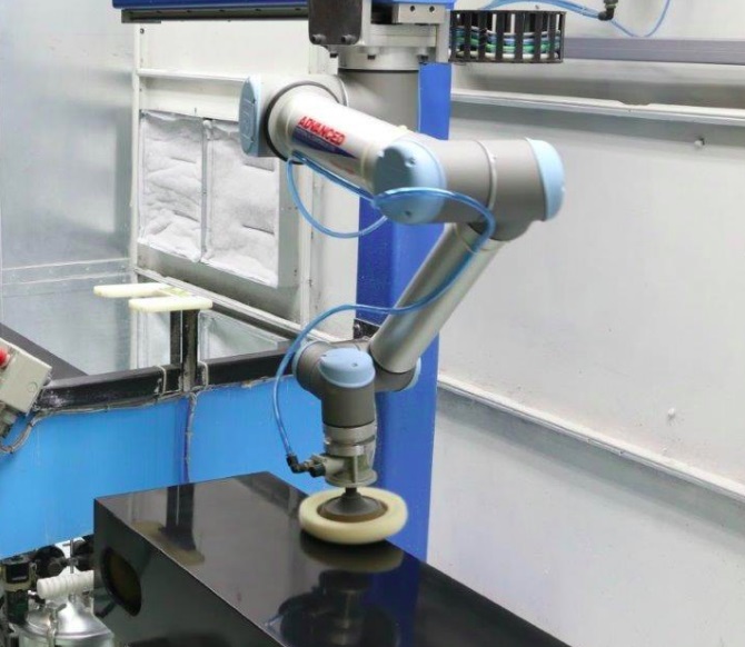

Cartesian force control applications have been the most recently explored domain for manipulators since the advent of cobots. Largely, dynamically-controlled contact forces ensure the consistent performance of the robot on the workpiece.

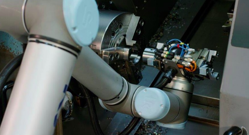

Deburring, polishing, painting, machine tending, variable load handling, and torquing are the most common applications that use the advanced techniques discussed above. Impedance control is designed with slight penetration along the direction of interaction and used for applications like deburring and polishing. Robust and adaptive control techniques can handle variable load making them suitable for painting or pick-and-place applications for heavy but unknown load with known/expected variation.
Figure 7. Robotic Polishing and Machine Tending Applications using Universal Robots’ cobots. Image courtesy of Brass Robotics.
