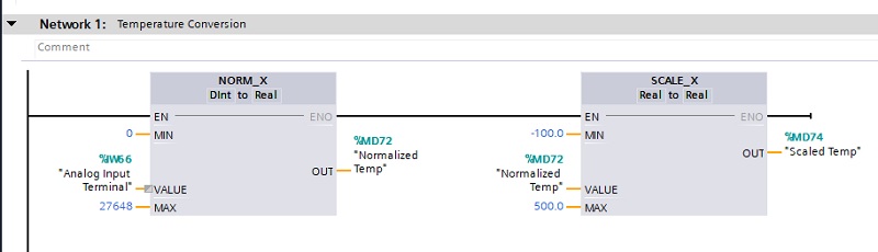

We need the instructions SCALE_X and NORM_X to scale an analog signal in TIA Portal. First, NORM_X normalizes the function’s input and returns a value between 0.0 and 1.0, depending on the MIN and MAX parameters setup. In other words, this function returns a number representing the percentage that the input is for the operating range, which is helpful because it makes the scaling process independent of the physical quantity unit of measure.
The normalized output then becomes the input of the SCALE_X instruction. SCALE_X converts the input into the data type of the output, and the conversion factor depends on the MIN and MAX values of this instruction.
The functions work for both input and output. For the input, NORM_X will normalize the readings from a sensor, while for the output, NORM_X will do the same for the physical quantity in its original unit of measure.
NORM_X and SCALE_X for scaling analog input
Figure 2. NORM_X and SCALE_X for scaling an analog input. Image supplied by Control.com

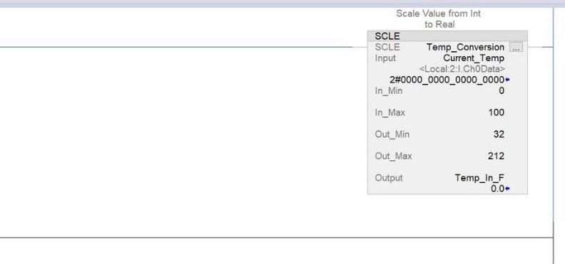

The most recent version of Rockwell’s software, designed for Control and CompactLogix platforms, does have options for scaling, but they must be downloaded and implemented as Add-on Instructions (AOIs). These are similar in function to the SCP implementation of RSLogix 500 and are available from the Rockwell support site. Alternatively, a user-defined AOI can be defined, as in the example in Figure 3 being named "SCLE", with a simple temperature conversion scale.
AOI to convert temperature scales
Figure 3. Add-on Instruction (AOI) defined in Rockwell’s Studio 5000 to convert between temperature scales. Image supplied by Control.com

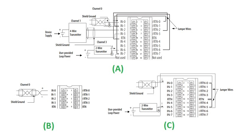

Correctly wiring an analog device is another crucial step to proper calibration and functionality. Unlike digital I/O, analog I/O always comes with at least two wires.
For current I/O, the current is calculated based on a known supply voltage applied to a resistor with a known value. This results in a closed-loop circuit formed by the I/O module and the analog sensor. Based on the closed-loop design, there are three main types of analog devices: 2-wire, 3-wire, and 4-wire. The names indicate the number of wires connected to the I/O of the PLC.
A 2-wire device is the most simple. One wire is the power supply, and the other one is the ground.
A 3-wire device introduces an external power source and isolates the power circuit from the current measurement secondary circuit.
A 4-wire device follows a similar concept as the 3-wire device but further isolates the power circuit by isolating the ground connections.
Different types of analog sensors
Figure 4. Different types of analog sensors are based on the number of wires. One module example wiring is shown with differential current (A), differential voltage (B), and single-ended current (C). Single-ended voltage simply consists of the voltage signal to the input terminal, all referenced to the control system ground. Image derived from Rockwell Automation literature
Wiring is more straightforward for voltage sensors and outputs because they are always 2-wire. One wire will be the voltage output, and the other one will be the ground connection.
