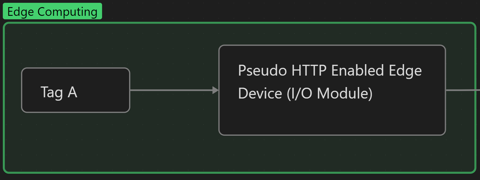

Simple single tag scenario
Figure 1. Edge computing layer of the earlier solution proposed in the earlier Web-based HMI series. Image used courtesy of the author

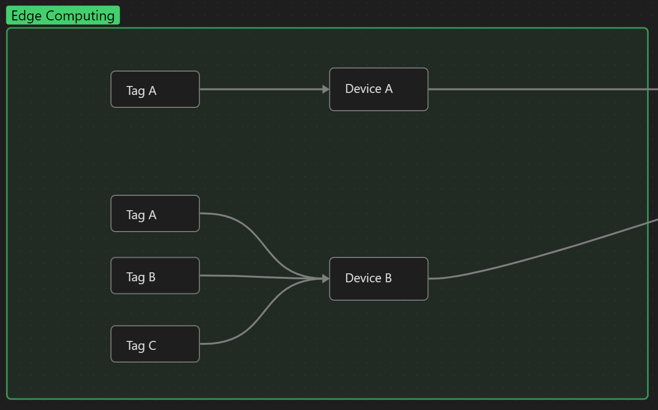

Multiple tag and device scenario
Figure 2. Edge computing layer of a more complex, realistic system. Image used courtesy of the author

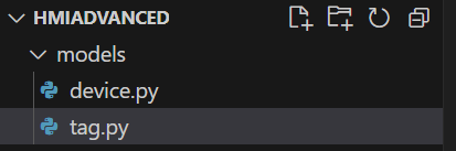

Project file structure
Figure 3. The model file structure. Image used courtesy of the author

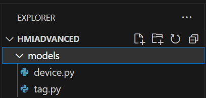

Project tag.py file
Figure 4. The tag.py file in the model structure. Image used courtesy of the author

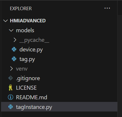

To see this in action, create a second file called tagInstance.py in the root project directory:
<projectname>/tagInstance.py
This should resemble something similar to the below:
Tag instance structure
Figure 6. Creating a single tag instance. Image used courtesy of the author

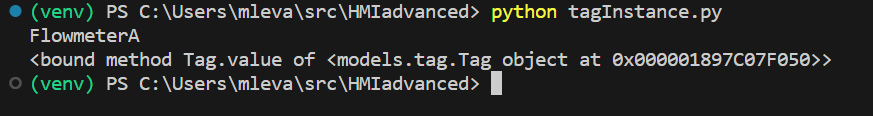

Now, what about the tag value? Let’s try calling the value method of the instance:
from models.tag import Tag
flow = Tag('FlowmeterA')
print(flow.name)
print(flow.value)
Returning tag value attribute
Figure 9. Tag value attribute, but only the memory location. Image used courtesy of the author
Again, we got something that isn’t very easy on the eyes. Our FlowmeterA tag instance is telling us that it has access to a method value that can give us the quantitative measure but is holding out on us. So how do we access the quantitative value as if it were a property similar to the name attribute? We can add a property decorator (denoted with the @ symbol in the code) within the models/tag.py file, thus creating a “getter” method:
