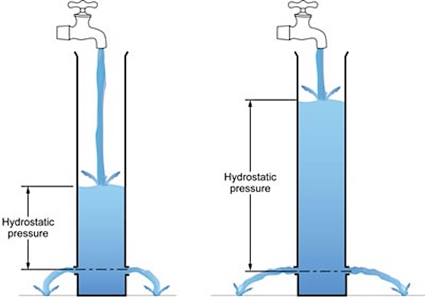

One method of determining the level of fluid in a tank is to use a differential pressure gauge. Typically, this is done by placing one end of the pressure sensor at the bottom of a tank and the other end exposed to the open atmosphere. It basically measures the gauge pressure of the bottom of the tank.
The pressure applied by the bottom of the tank is also called hydrostatic pressure. Hydrostatic pressure is governed by the equation below:
Phydrostatic = ρ * g * h
where ρ is the density of the liquid, g is the gravitational acceleration constant (9.81 m/s2 or 32.17 ft/s2 on Earth), and h is the height of the liquid in the tank. Notice that volume does not enter this equation at all—the hydrostatic pressure is the same at the bottom of a thin, deep tank as it is a very large tank with the same height.

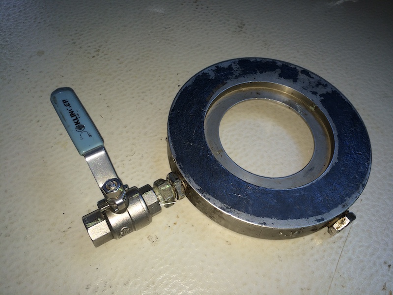

critical orfice plate
Figure 2. A critical orifice plate. The inner diameter of this orifice must be smaller than the pipe diameter.
Differential pressure measurements can determine how much fluid flows by taking advantage of this same effect. A differential pressure measurement can be placed along a pipe. A plate with a small hole, called a “critical orifice plate,” is placed between the two sensing elements. The higher the flow through the pipe, the larger the pressure drop will be across the critical orifice plate.
In fluid dynamics, the Bernoulli Equation and the Venturi Effect are used to relate fluid speed, pressure, nature of flow (laminar versus turbulent), and the size of the pipes (and critical orifice plates). A full explanation of these equations is beyond the scope of this article.
The key to good flow meter measurements is to verify the critical orifice diameter and ensure that it is the smallest diameter (biggest restriction) in the flow path. While the flow can be calculated from the fluid dynamics equations, sometimes, it is difficult to find all of the parameters needed for these equations.
Instead, the flow rate can always be calculated against a trusted flow meter, or, for non-hazardous liquids, a simple “bucket” test, where fluid is allowed to flow into a bucket and weighed for a specified amount of time to find a mass flow rate.
