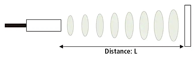

Ultrasonic Level Detection
An ultrasonic sensor sends an ultrasonic sound wave and measures the signal’s response time. The longer it takes for the signal to return to the sensor, the further the object. Once we know the product’s level in a vessel, we can determine the volume or percentage of the filled vessel.
Figure 2. How ultrasonic sensors work. Image used courtesy of Keyence
The advantage of using an ultrasonic sensor is it doesn’t matter how corrosive or abrasive the product is—nothing touches the sensor. The downside is the signal is sensitive to temperature, wind, and pressure. Companies such as Hawk Measurement create solutions to this problem, such as using microwave technology. Similar to ultrasonic, microwave signals are not susceptible to temperature or pressure.

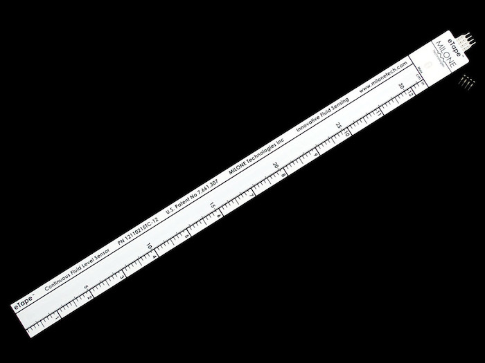

Resistive Tape
While ultrasonic sensors are usable in many conditions, they have limitations. If your project doesn’t require an expensive ultrasonic sensor or you have a small amount of fluid to measure, a resistive tape solution might work.
Resistive tape or liquid level tape measures the pressure that the fluid exerts on the tape—much like how a load cell measures the weight of an object resting on it. As the fluid volume increases, so does the pressure on the tape, and electrical resistance is reduced.
Figure 3. Resistive tape. Image used courtesy of Adafruit
By applying a voltage through this resistance and measuring the voltage from the tape, we can determine the volume in the vessel. Some scaling within the control system is required to show a volume in engineering units, but because the change in resistance is linear, we can use the simple y=mx+b formula.
The tape needs to be in the solution to measure the level, so depending on the solution, it may not be compatible with the materials from which the tape is made. Temperature is also a factor; the above example has a temperature rating of -9 °C to 60 °C. Additionally, resistive tape is typically not very long, usually around 400 mm.

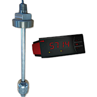

Continuous Level Float Sensor
A level float sensor is typically made of reed switches and resistors inside a tube that read the position of a float outside the tube. As the float rises and falls with the level, the resistance within the sensor changes, similar to the level tape.
Figure 4.  A continuous level float sensor. Image used courtesy of Innovative Components
Similar scaling is required within the control system. Unlike the level tape, the level float sensor usually has an analog output that can be quickly scaled within a PLC or microcontroller. Most level floats are made of stainless steel, so they will not be affected by the solution they are submerged in. Because of the analog output, float sensors can be easily connected to a panel meter requiring no control system or programming.
