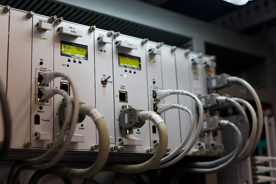

First, the background of ladder logic may provide some context for the popularity of this programming method. PLCs were initially designed to replace relay logic controls. These relays used coils and contact sets to perform massive sequences of instructions. The PLC replaced the relays with a much smaller, more efficient form factor. The electricians working on the relays had to shift skills to working on these computers instead.
An industrial PLC used in a facility.

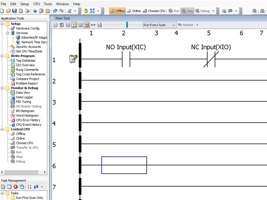

A block is usually a square with inputs on the left side and output on the right. As an example of what this may look like, many typical math and inequality instructions and timers and counters are usually functional blocks inserted into ladder rungs.
The unique part about FBD programming is that there are no ladder rungs, and the function blocks are connected in free space. For most PLC programmers, the shift from ladder (LAD) to FBD programming isn’t too difficult.
A sample of the ladder diagram commonly used.
The FBD language would be primarily used when most of the data is analog or integer values for which the simple coil-contact setup of ladder diagrams would not work well. In those cases, the ladder diagrams already consist almost entirely of function blocks, and FBD programming may simplify the programming with better capabilities.

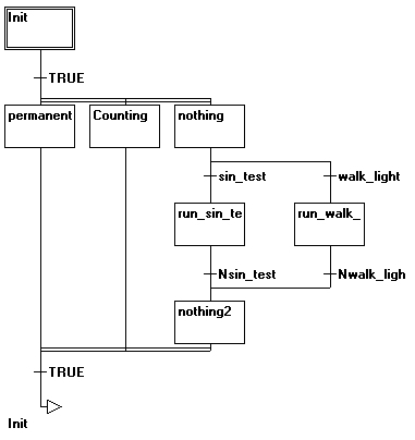

Sequential Function Charts (SFC)
This language could be simplified with the word ‘flowchart’. It is quite different from ladder logic in which each rung is an entirely separate operation. Sometimes, one rung may influence another rung, but each rung is still examined and calculated as a unique tiny program.
In complete contrast, Sequential Charts cause conditions and values to have a single starting action or operation, which leads to subsequent steps as long as conditions are met. This programming language can still perform all the necessary calculations and networks with external equipment (sensors, motor drives, etc) but everything is represented as a sequence of steps.
Ladder logic is preferred for continuous processes such as assembly lines or distribution centers where inputs are continuously examined, and outputs are continually activated. However, SFC is ideal for batch-type functions that have a very defined starting point, and an easily measurable progression of steps leading to a conclusion. Quite often, these processes will be drawn up as a flowchart on a whiteboard, and this makes a perfect candidate for an SFC program.

Example for a network in the sequential function chart. Image courtesy of Beckhoff Automation
