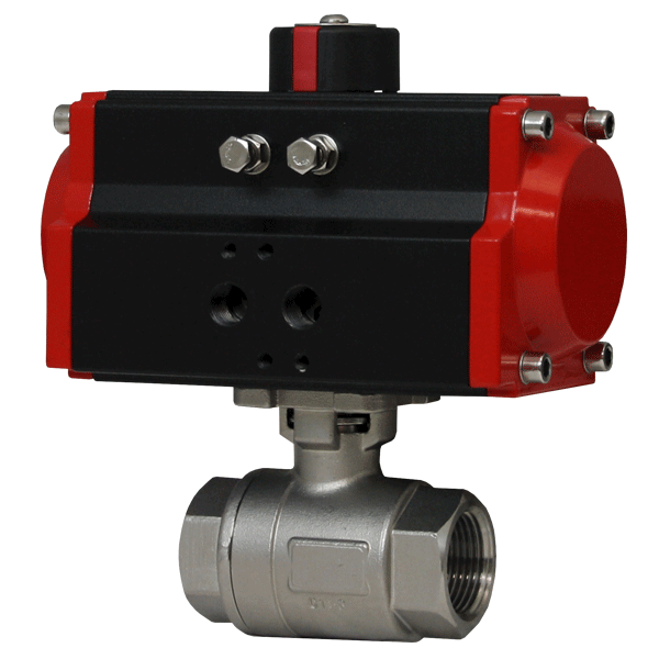

V Ball Valve
The main characteristic of the v ball valve is the v-shaped contour in the ball instead of the standard bore in the ball. The angled contour provides more control over fluid flow with an increased response time that may not be possible with other control valves.
ball valve
Figure 1. A V ball valve. Image used courtesy of Dwyer
For this reason, a small-sized v valve can achieve higher fluid flow characteristics than other larger-sized control valves. V ball valves can also be used at high fluid flow pressure applications.

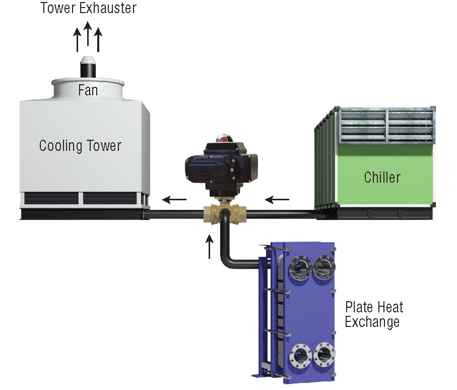

Strict Control of Pressure Leak
Ball valves are used in gas and liquid applications requiring strict leak control practices. The fluids may be expensive or deadly to humans, such as toxic chemicals. This is often the case in industries where the fluid leak is unacceptable, such as in laboratories.
Figure 3. An application of ball valves. Image used courtesy of Dwyer
Ball valves provide accurate sealing of valves both at the inlet and outlet. The valve structure and material also make it challenging to leak through the valve body.

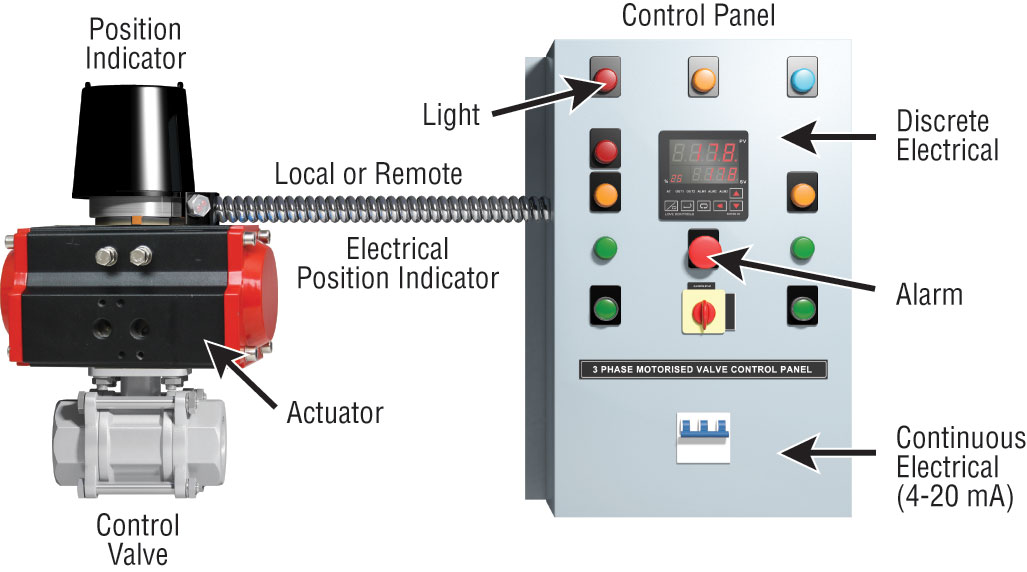

Instrument Connection
Ball valves can connect instruments such as air pressure sensors or pressure gauges with the network to measure and monitor fluid characteristics where required.
Figure 4. An application where a ball valve connects system components. Image used courtesy of Dwyer
The selection of the ball valve depends on the instrument and fluid characteristics. To connect the instrument, the ball valve attaches to the fluid network. The instrument is then connected to the ball valve. In the event of fault or maintenance, the ball valve disconnects the device from the attached network. This enables the maintenance personnel to carry out the maintenance activity without disturbing the fluid flow in the connected network.
