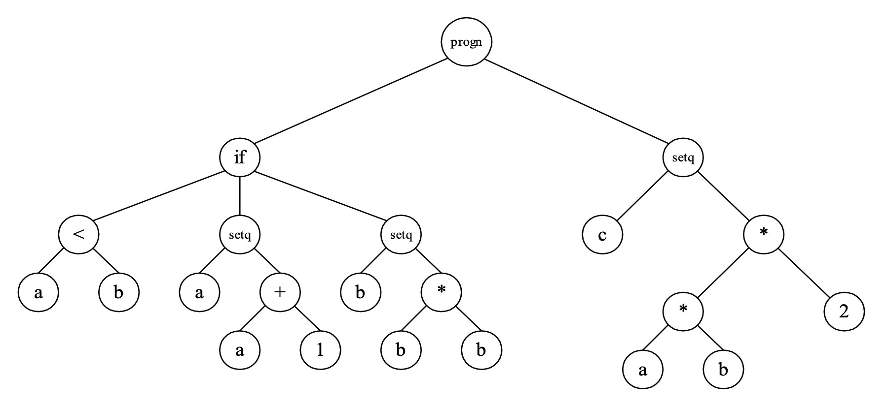

The tree-based representation mentioned earlier is central to the GP theme as virtually any computer program may be represented in this way. In practice, a functional language such as LISP is well-suited to this form and it is easy to see how a LISP S-expression can be diagrammed as a tree (Figure 1).
Below, you’ll find three separate representations of the same information:
A simple program fragment:
BEGIN
IF a < b THEN a := a + 1 ELSE b := b * b
      c := a * b * 2;
END
LISP equivalent:
      (progn (if (a < b)
            (setq a (+ a 1))
            (setq b (* b b))
      (setq c (* (* a b) 2))
Figure 1. Tree representation of a program. Note that (progn arg1 arg2 arg3 ... argn) sequentially evaluates each argument.
