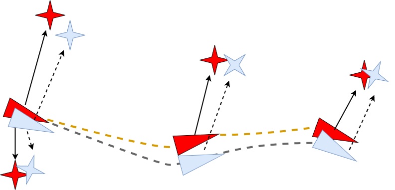

Robot Localization Algorithms
The robot pose is a vector and thus can be defined in different reference frames. Measurements from cameras and rangefinders are converted from their local reference frame to the robot frame for localization. Absolute robot pose and absolute landmark positions are determined with respect to a common global reference frame.
Figure 1. Localization using landmarks. Red = Actual, Blue = Probabilistic
Localization algorithms use multiple sensors, data association, and correction techniques to determine the most accurate robot pose. The individual algorithms and techniques for robot localization include:

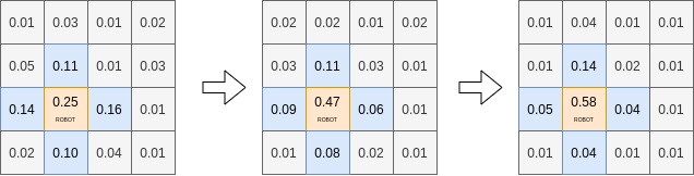

Markov Localization Algorithm
The Markov Localization algorithm starts with an arbitrary probability distribution for the robot's existence in each discrete pose and updates it over time using sensor and odometry information. Keeping track of such large states and individually updating the probabilities is memory- and time-consuming, thus very inefficient.
Figure 2. Continuous pose probability updates
